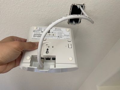

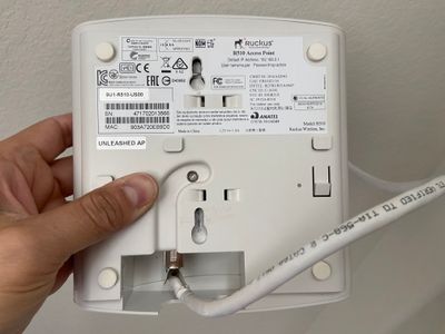

Ruckus POE Zoneflex R510 stopped working. There are no lights on the access point. We have two APs. Only this device stopped working. The other AP is working just fine. Can you send me a replacement access point under the lifetime warranty program? How can I send you photos. Thank you!

Can you send me a replacement AP? We replaced the switch two years ago when it went bad under the lifetime warranty program.

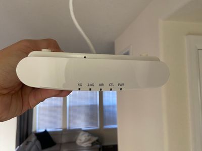

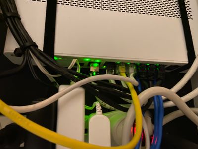

Have tried unplugging and plugging it back in. Thereโ€™s light at the switch in the basement, however, thereโ€™s no power on this AP.
The Ethernet cable is roughed in when the home is under construction. It feeds from the basement tech box to the main level. Thereโ€™s nothing wrong with the CAT6e cable. Its not damaged as itโ€™s been in the wall & ceiling the entire time.
This AP is either defective or it simply stopped working. The main AP on the upper level is fine. Itโ€™s still under warranty.
See attached photos.โ€ƒ
โ€ƒโ€ƒ
โ€ƒ

Tried the suggested solutions and thereโ€™s still no power to the Access Point. Itโ€™s a hardware issue.
Additionally, I disconnected the working access point and hooked it up to this Cat6e cable and it works. I also then connected the defective AP to the other location and still no power. The device failed after 5 years.
