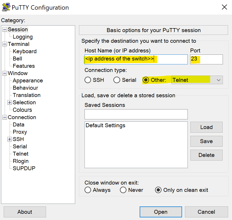

Could you please try to use the Telnet option that doesn't require username and password. Refer to the screenshots below.
Telnet – Port 23 (If SSH doesn’t work)
ICX7150-C12 Router> OR
ICX7150-C12 Switch>
show version
show flash
Please let me know how it goes.
