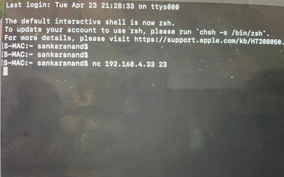

Hi @tandemsankar
If you are using MAC, try to access CLI using Telnet as described below.
Example "open terminal":
Telnet: Example
nc 10.0.0.132 23 (Format is : nc <ip address of the switch> 23)
????telnet@ICX7150-12P Switch>
Please confirm if you can access CLI using Telnet and let me know if you have any queries in this regard.

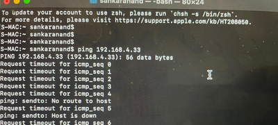

04-23-2024 06:39 PM
Hi Imran,
I have tried above step, Unable to access CLI via telnet. Please find the screenshot for your reference.
I also tried ping, no response, attached screenshot.
