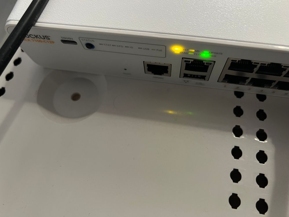

Ruckus ICX 7150-C12P router not working after the sudden power outage.
1. Tried to disconnect from the Power outlet the ICX-7150 and reconnected.
2. tried to press the reset button
Currently no power is being sent to the WAPS upstairs or downstairs and I cannot find the internet signal from the LEnnar Router .
I can only “find” the internet signal sent from my XFINITY set up

Hi @Help-needed
Greetings of the day,
Thanks for your response,
Based on the description it seems like your switch is stuck in boot mode. As the factory resetting process doesn't work we request you to perform the software recovery process by using the below guide.
Note: after fixing the issue of the Switch been stuck in boot mode, please perform an upgrade to the code 08095g UFI and upgrade both partitions with the switching code file named SPS08095gufi.bin, so perform the software recovery using the code 08090k with the upgrade image file named SPS08090k.bin, then when the switch is back to normal upgrade to the file SPS08095gufi.bin for both partitions primary and secondary.
