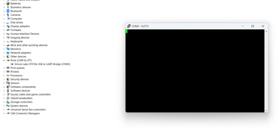

04-18-2025 11:35 AM - edited 04-18-2025 11:36 AM
Thank you for the instructions, shows up as COM3. I have opened COM3 in Putty as before. The drivers are good! I downloaded, reinstalled and rebooted.
04-18-2025 01:03 PM
Hello @DavidM ,
Thank you for sharing the information.
Based on the troubleshooting done, your ICX-7150-C12P Switch is stuck in bootmode and tried to complete the software recovery. However, you were unable to complete the software recovery as there is no response from Putty app. This Switch unit Should be RMA (Return Merchandise Authorization) in simple words replacing it.
