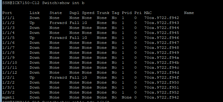

06-26-2021 09:28 AM
In addition to the above commands suggested by Dylan, the Ruckus Support suggested the following.
1. Once you are in the telnet session
2. Switch to EXEC mode using the ENable command
3. "show int b" (this command will show all active ports
