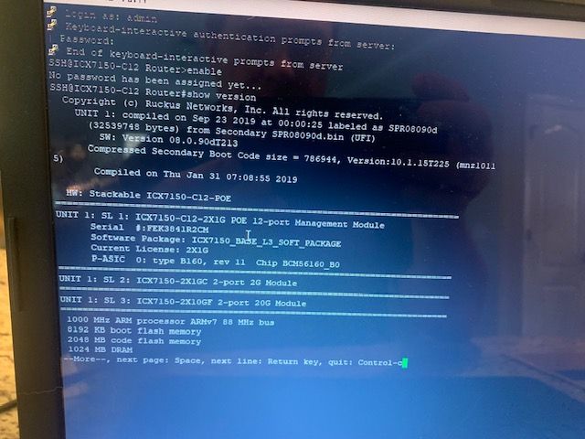

This issue is because your switch is running on the Routing code (SPR). The Switch should run on the Switching code (SPS) to avoid these issues for Lennar home users. Due to a power outage/power spike, the Switch boots up on the other partition which may be running on a ‘Routing Code’ results in causing this issue.
As I can see from the output you shared, your Switch is booted up on the secondary partition which is running on Routing code (SPR) as highlighted in the below screenshot.
Please Enter the below commands in CLI to fix this issue:
copy flash flash secondary
Example:
VIDEO LINK AS REFERENCEhttps://www.youtube.com/watch?v=Eem1IBgYaWc
ICX7150-24P Router#copy flash flash secondary (hit enter to accept the command and wait: until the flash finished)
ICX7150-24P Router#boot system flash secondary yes (hit enter to accept the command: the switch will reboot)

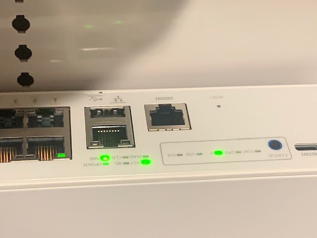

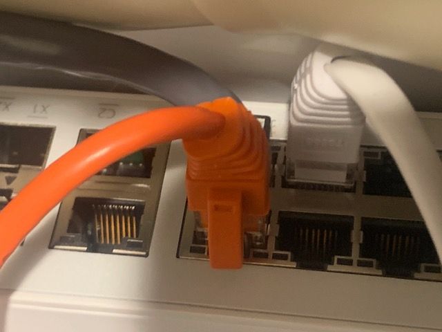

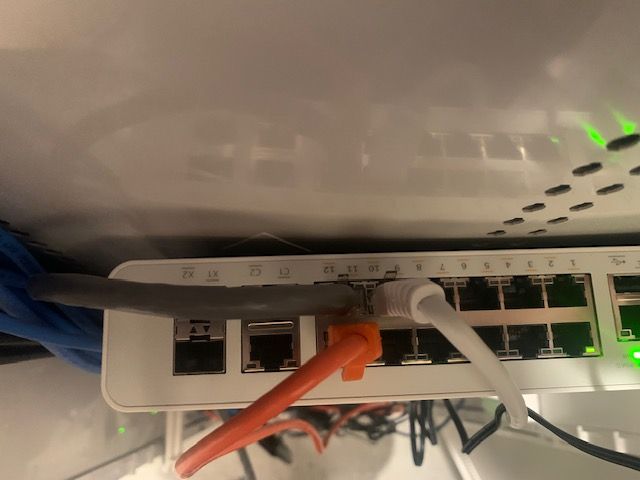

2. On your switch while it's plugged into the outlet, do you see any lights on? (Amber or green) Please let us know which lights are on. (Please refer to the below picture and share a picture of the same, showing the light status and the FULL Switch panel cable connections to the Switch ports)
Before uploading the photos, please log in to the RUCKUS account and you can upload the image.
Please let me know the answers to ALL the above queries or let me know if you have any queries in this regard.
SteveI
Yes, it worked when I purchased the home.  I have experienced power outages since then.
InformationInformationInformationInformationin hallwayin hallwayLightsLightsEthernet CablesEthernet CablesEthernet cablesEthernet cables
Example:
