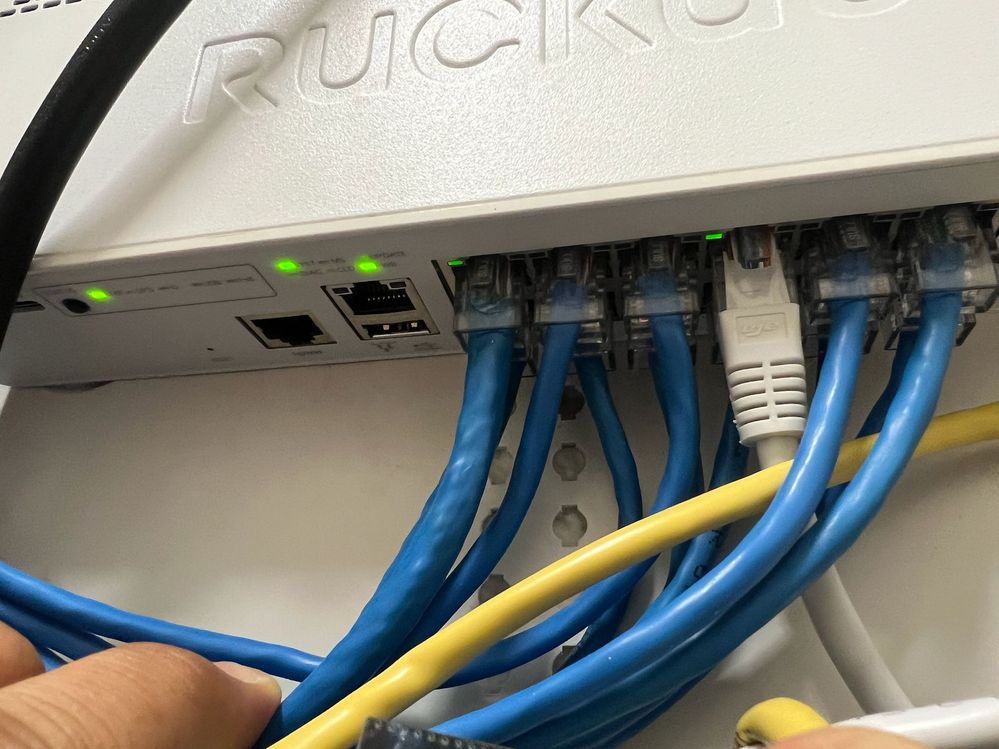

After I replaced my WiFi router, Ruckus Switch started receiving the internet via LAN and Access points are getting Internet connection too. However, as attatched in the pic, except 2-3 ports on the Ruckus switch none of the other ports are working.  Please see the picture below - only the ports which are connected to Ruckus access points and incoming LAN are lit and rest of the ports are not working.  I think you will have to issue me a new Ruckus Switch .Switch_connection.jpegThe Other ports on the switch make connection to the entire house for Internet Wire connection.
