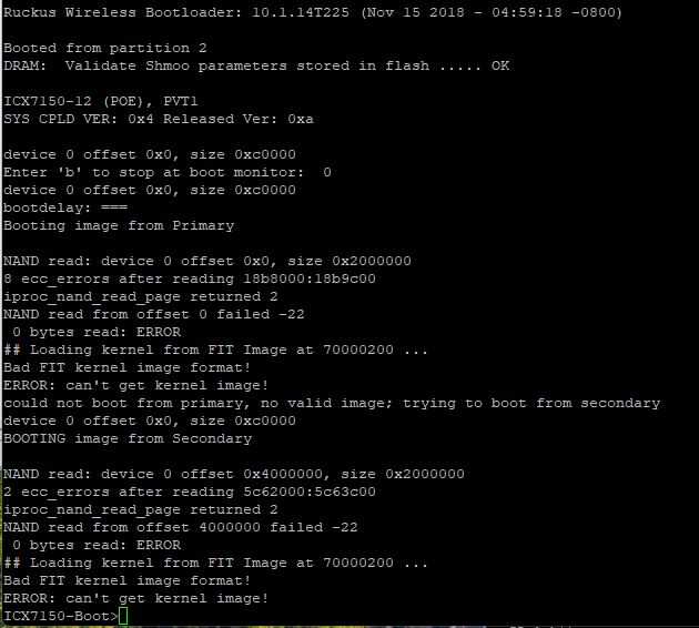

09-08-2023 09:07 PM
I get this from the console port.
What is the next step please?

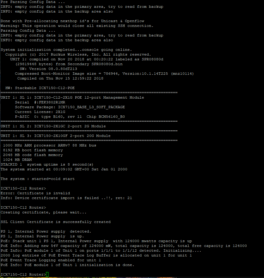

09-08-2023 09:14 PM
I can type reset at the prompt, then it takes a while but enters in the router mode, but it looks like there's no network at all.
