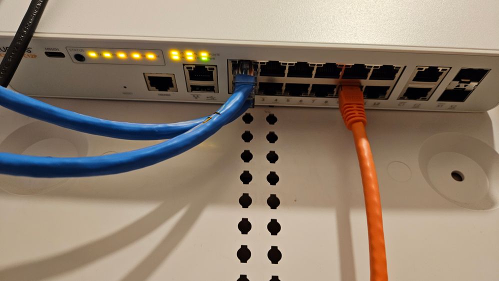

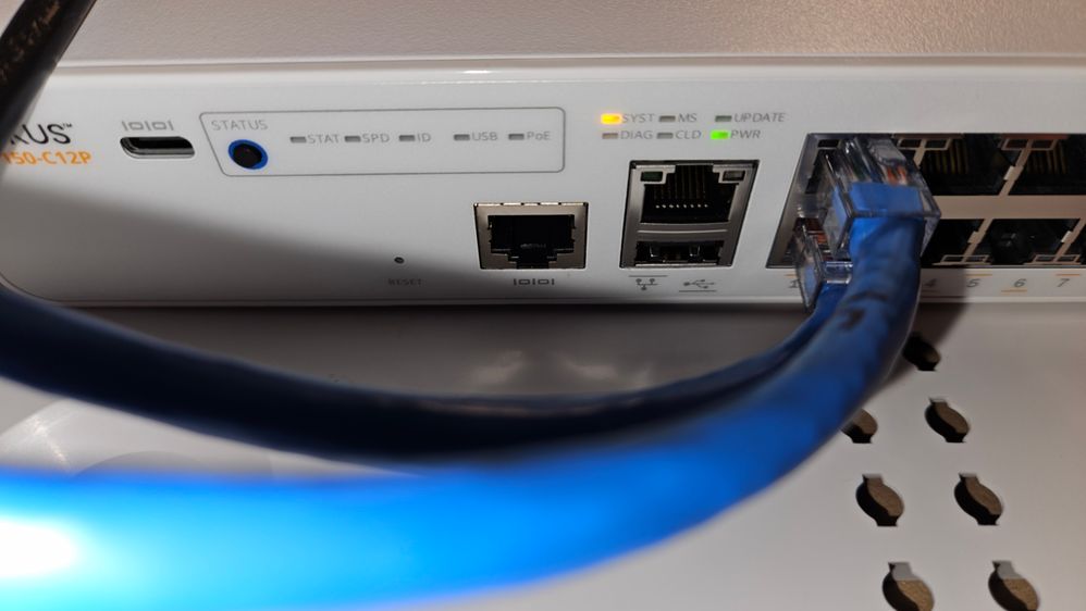

Hello. I noticed that my AP's are not on. I researched and troubleshooted the issue but I can't get them to work. I have also tried to reboot my Ruckus switch but I haven't been successful. In trying to do so, I get a row of blinking orange lights and a green power light. Please help.

On your switch while it's plugged into the outlet, do you see any lights on? (Amber or green) Please let us know which lights are on. (Please refer to the below picture and share a picture of the same, showing the light status and the FULL Switch panel cable connections to the Switch ports)

Following the reset process by unplugging switch, holding reset button and connecting it backFollowing the reset process by unplugging switch, holding reset button and connecting it backBefore trying to resetBefore trying to reset
Hi @giovany8a
I see from the pictures you shared, that there is an Amber/Orange light on the SYST and Green on PWR. This means the RUCKUS ICX-7150-C12P Switch is stuck in boot mode.
Did you try to reset the Switch Multiple times using the paper clip? If not, please try it. If that doesnโ€™t work, you need to perform the software recovery on the Switch.
Please refer to the below RUCKUS Lennar Knowledge base self-help article explaining the troubleshooting steps.
https://community.ruckuswireless.com/t5/RUCKUS-Lennar-Support-Knowledge/Fixing-RUCKUS-Switch-with-an...
Please let me know if you are stuck at any point during the process and let me know if you have any queries in this regard.
