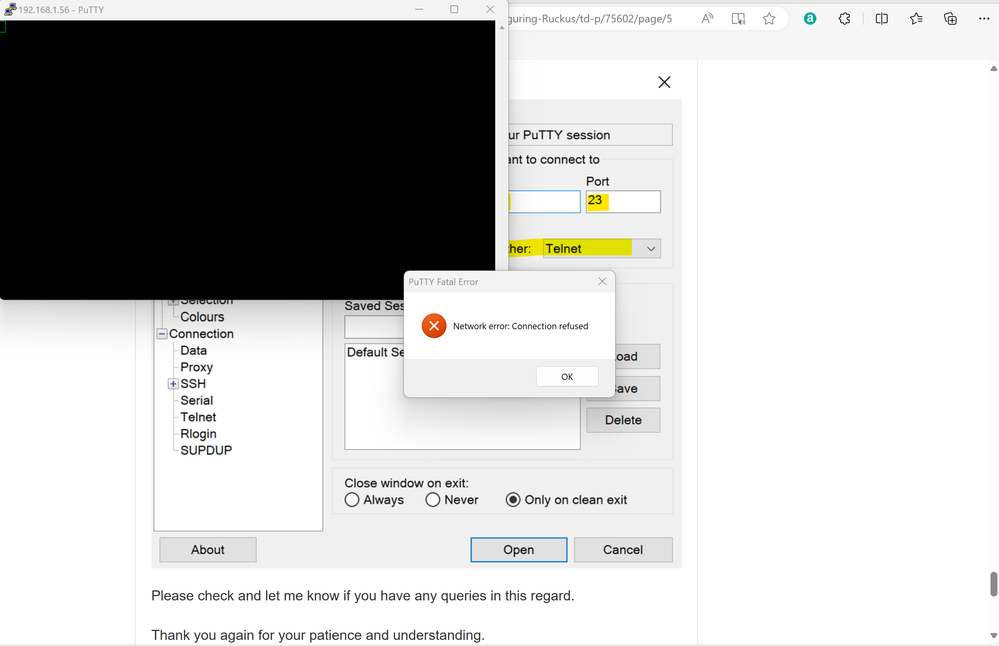

The Telnet putty connection fails.  I am receiving a fatal network error.  Please advuise.switch errors 3.png
Hi @theotherone89
Could you please try to log into the Switch on the web browser using the default credential?
Switch default credentials will be as mentioned below.
Username: super
Password: sp-admin
If the above credentials don’t work, you can try below default credential combinations as well.
If any of the above credentials doesn’t work, please try to factory reset the RUCKUS ICX-7150-C12P Switch as described in below VIDEO and once you perform the reset try to login with the above-mentioned default credentials again.
VIDEO link: https://www.youtube.com/watch?v=6jHMTdo_hK4
