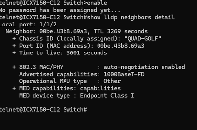

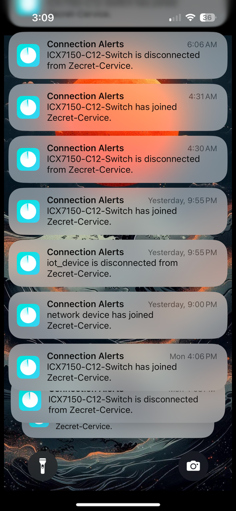

The TP Link Mesh is directly connected to the Kinetic Fiber ISP that then feeds the switch IP addresses. So the (1) master mesh unit will run Wi-Fi continuously even as the switch goes through it's failure. I know this as I have a TV that connects via hardwire ethernet to the Ruckus switch and then has to switch its connection to the master wifi mesh when the switch goes down. So I'm confident that the ISP service is solid 24-7. I also have my phone configured to connect to the master wifi and when the Ruckus switch goes down, I know this also from a message that the TP-Link unit sends to me as a message, I can still ping SpeedTest as well as all other functions on my phone being connected.
Now, the other mesh units are split between being hardwired and on wifi and act the same way when Ruckus goes down.
Let me know what this screen shows tells you, I'm curious.
09-04-2024 12:00 PM
Hi @daddygoat
It appears that the output does not provide information related to the mesh, as your Mesh APs are directly connected to the ISPs Router.
I recommend connecting your RUCKUS ICX-7150-C12P Switch directly to one of the LAN ports on your ISP's router. You can then connect other wired devices to the Switch. Please refer to the following screenshots for guidance:
If you have any questions or need further assistance, please let me know.
Thank you for your patience.

I do not use a router from my ISP and when I've tried to direct connect the Fiber to the Ruckus switch, I was never able to get the switch to distribute IP addresses nor was the Ruckus AP able to grab an IP address. This was tried many months ago when I the AP was still in use.
The ruckus switch is dropping off the network in rapid succession.
