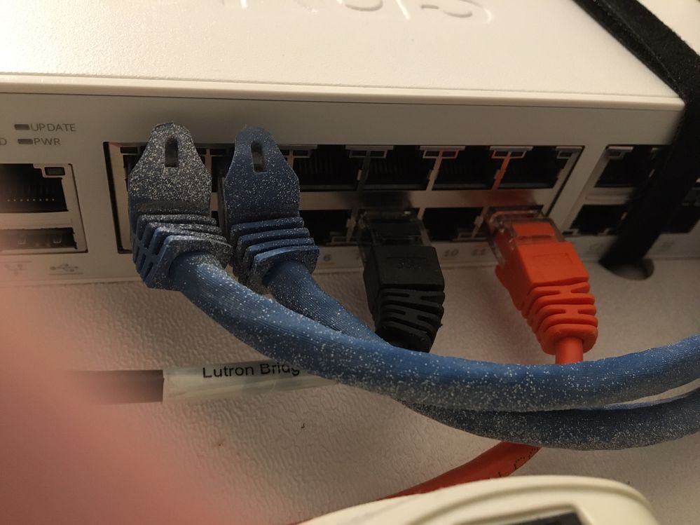

Also please share the image of the switch and access points showing LED status and the cable connections.
Hello Jayavidhya,
We have two access points in the ceiling represented by the two(2) blue wires in the picture.  They are not live at this and have no lights.  They are identical to your image.IMG_2717.JPGIMG_2718.JPG
time as the Ruckus is not up and running.
LED lights are:  Green power and Amber system. Those are the only lights lit.
The only wired connections are:
ORANGE goes to the Frontier internet modem
Black was a Lutron device for lights but I have that disconnected
BLUE are the AP's in the ceiling which are currently not working.
