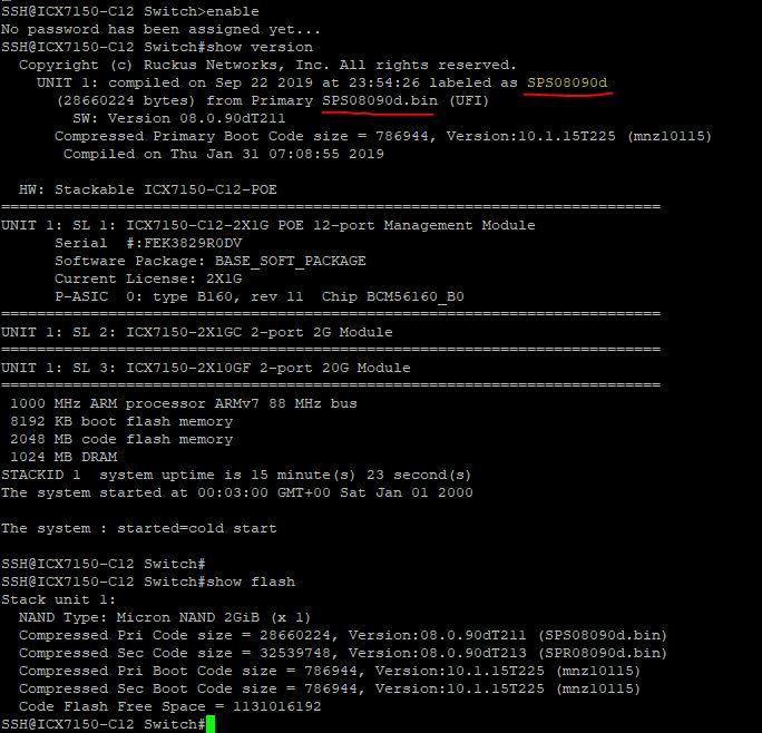

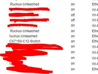

Below are some screen shots. Perhaps all I needed to do is to boot from primary, which has the switch code. secondary has the router. Looks fine to me. The other screen shot is a list of devices that were previously off before this work around. I need to confirm if that fixed our network problem.

what shows in my network devices - those were all off previouslywhat shows in my network devices - those were all off previously
