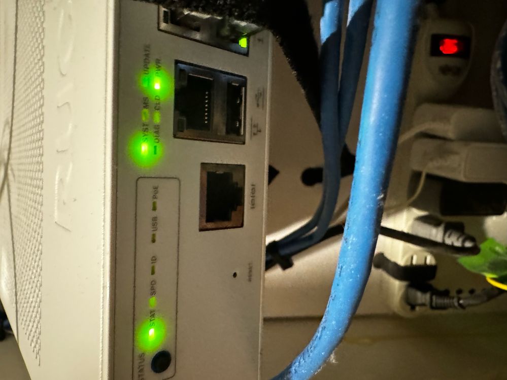

2. When your switch is plugged into the outlet, are any lights illuminated? Kindly specify if you observe any amber or green lights, and if possible, could you please share a picture displaying the light status and the complete switch panel cable connections to the switch ports? (Please refer to the provided picture as a guide).
3. Is your internet connection from the Internet Service Provider (ISP) stable and operational? You can verify this by connecting to your local router Wi-Fi or via an Ethernet cable from the router to a laptop/PC.
Please provide images of your ICX-7150-C12P Switch depicting the status of the lights and cable connections to the switch ports?

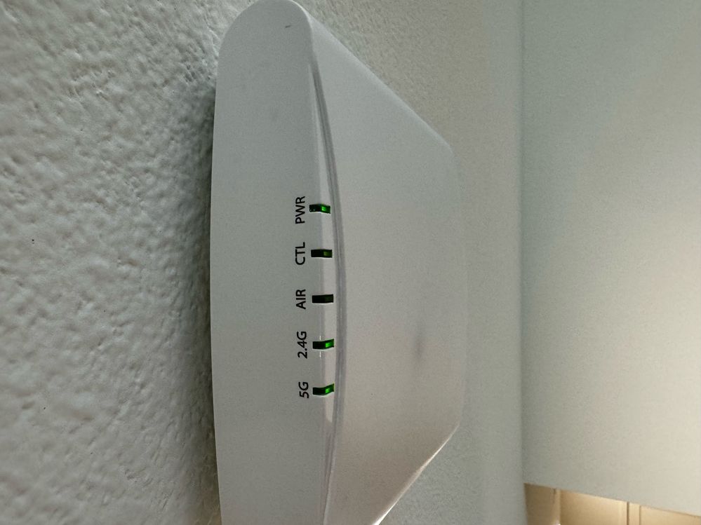

Please see the image the summarize:
  1. 5G: Green Light
  2. 2.4G: Green light
  3. AIR: No light
  4. CTL: Green Light (Seems lighter than others)
  5. PWR: Green Light for

Hi @chocolateruck
Could you also please share a picture displaying the light status and the complete switch panel cable connections to the switch ports? (Please refer to the provided picture as a guide).
