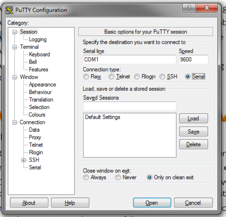

5-Open a session in putty or MobaXterm with the following settings:
This is a putty session:

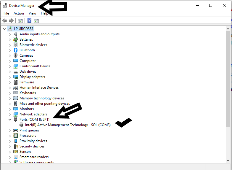

NOTE: The “Serial line” will change from “COM1” to “COMx”, it depends on how many connections your computer currently has. To identify the one, we need go to “Device manager” and locale the USB console connection. In the following example is letting us that the USB is on COM3
