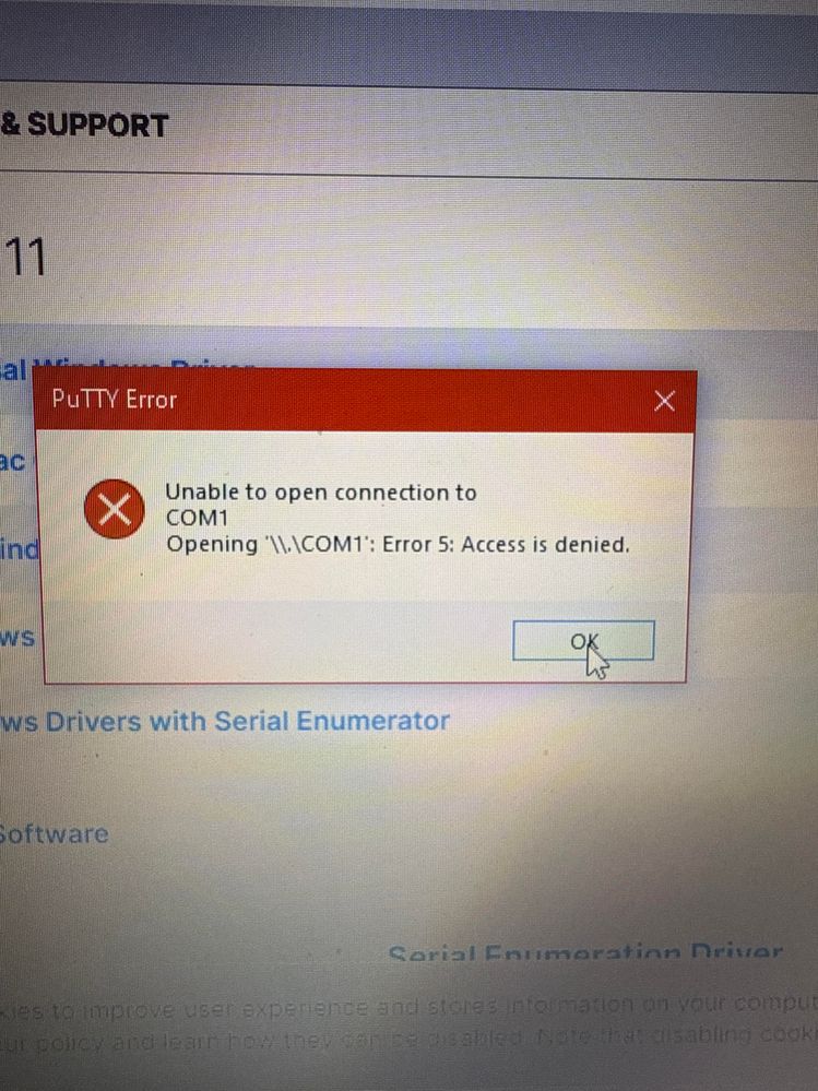

Hello @kenny23 ,
Thank you for the response and sharing the pictures.
I understand that you are unable to type anything in the Putty and getting error that the access is denied.
Please make sure to download the zip drive for the file below & "extract all". Once it's extracted, run the file, the driver should be installed using the 2 links below.
Link 1: https://support.ruckuswireless.com/software/1414-brocade-ruckus-7150-usb-serial-driver-windows
Link 2: silabs.com/developers/usb-to-uart-bridge-vcp-drivers?tab=downloads
Could you please restart the laptop after installing the drivers and check the COM port details in the Device Manger from the Control Panel?
COM port details should be with the silicon lab name in the device manager.

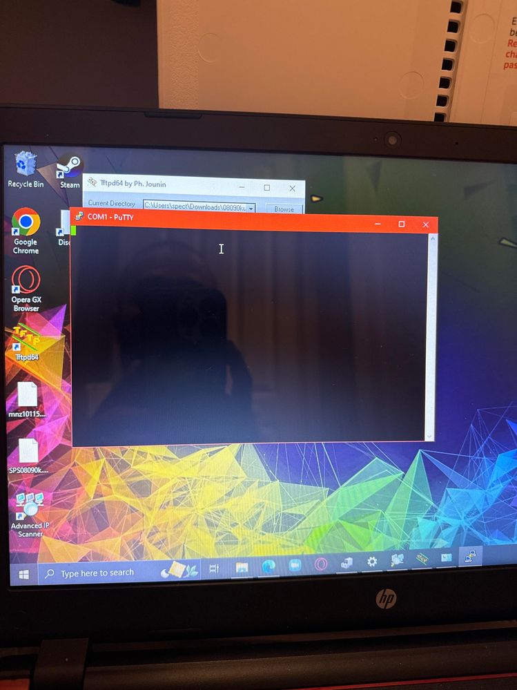

10-30-2024 07:08 PM
thank you. i followed your directions, ive gotten further. but stuck again, pls help attached photos not alive in ping test
