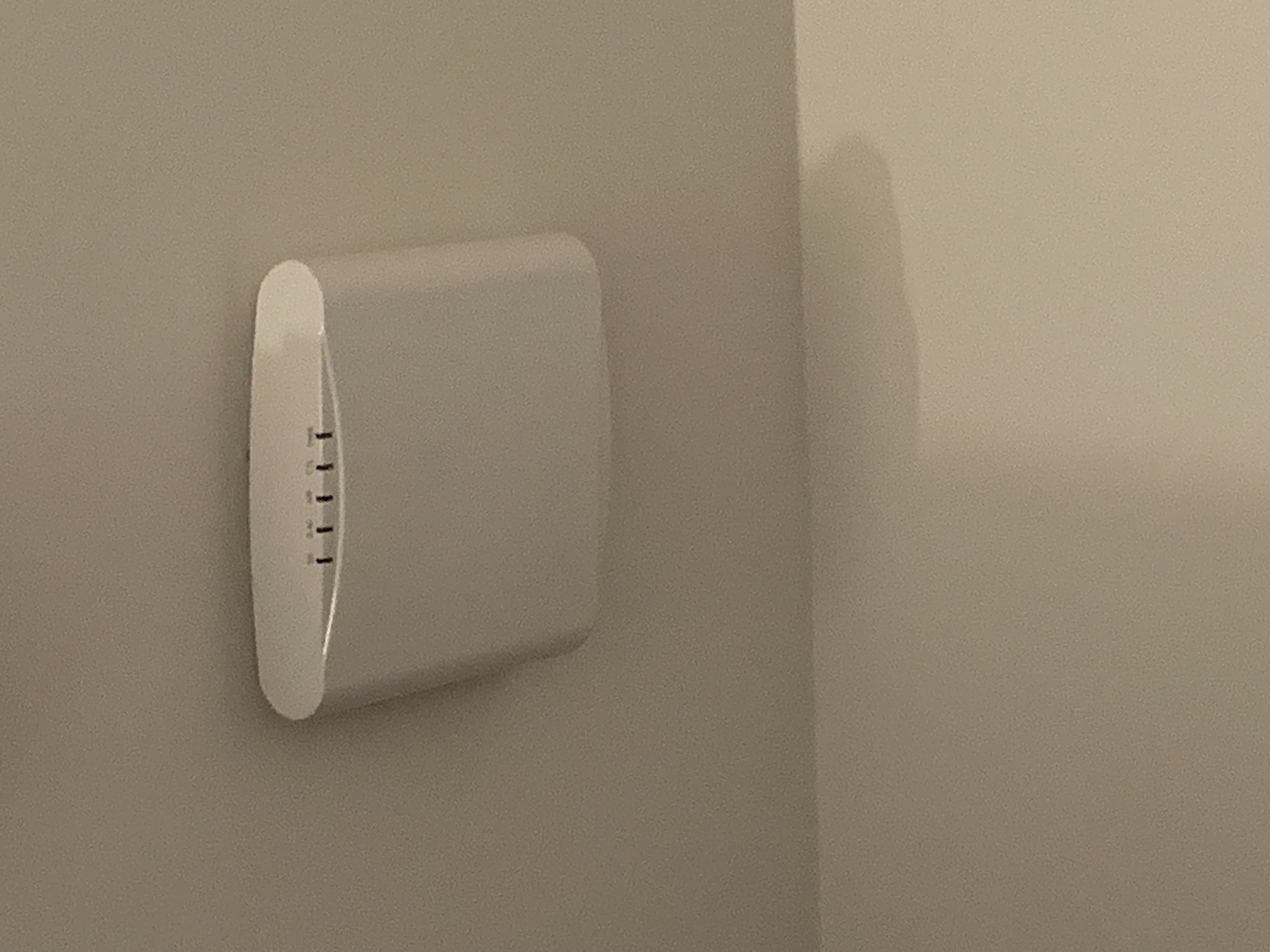

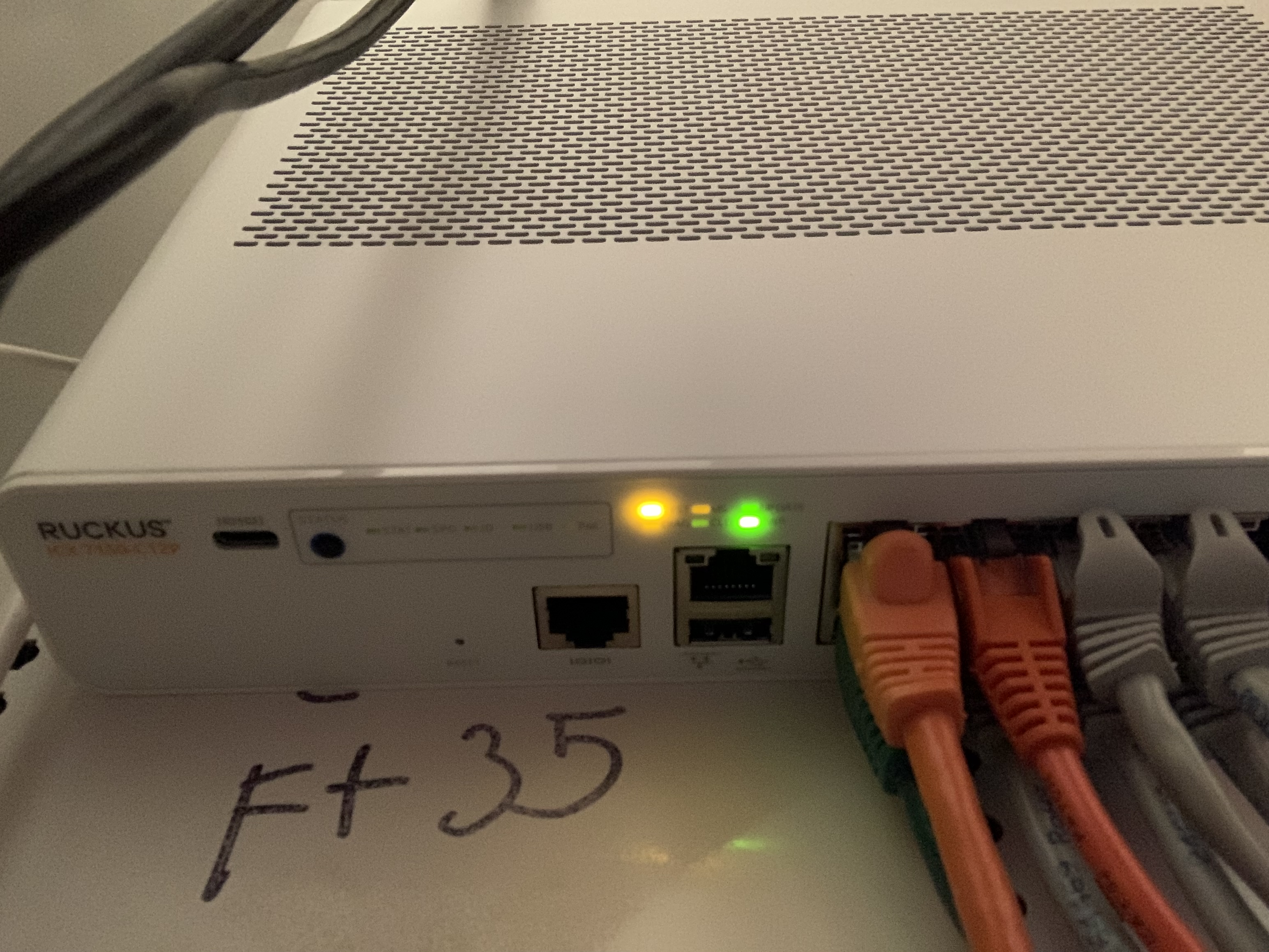

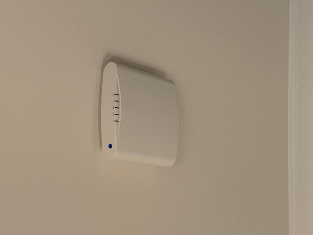

01-02-2023 09:36 AM
I tried all the steps and the waps still won’t light up. What next?
