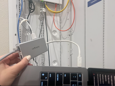

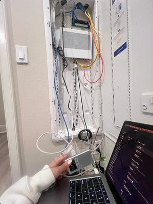

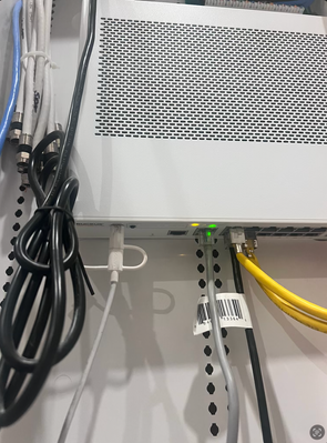

Here I've attached pictures showing the Software Recovery cable connections between the RUCKUS Switch and your laptop.

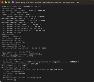

And I've included the terminal error I get when trying to perform Software Recovery on my mac.

Based on the troubleshooting performed, your ICX-7150-C12P Switch is not responding properly, and the Software Recovery process has been unsuccessful. A hard reset was also attempted; however, the issue still persists.
As a result, this Switch unit appears to be defective and needs to be replaced through the RMA (Return Merchandise Authorization) process.
