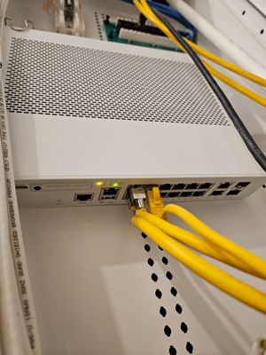

After an outage on 8/5/23, Both floor routers won't light up.
The switch has a yellow light on the Synt.
I am unable to remove the router on the ceiling to try to physically reset.

Both of them are black, no power.
Hi @Aahn
Thanks for your response.
Based on your description your switch has one green and one yellow light, it means that the switch is stuck in boot mode.
  1.  Remove power from the switch.
