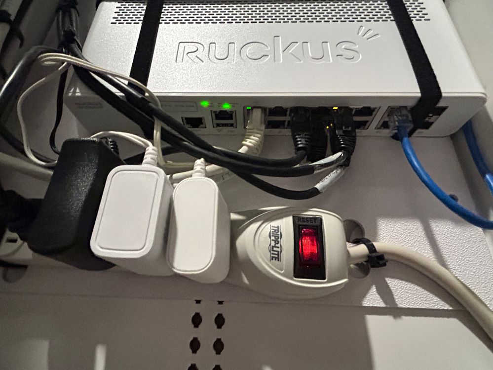

2. Yes, the switch has some lights on - see attached picture.

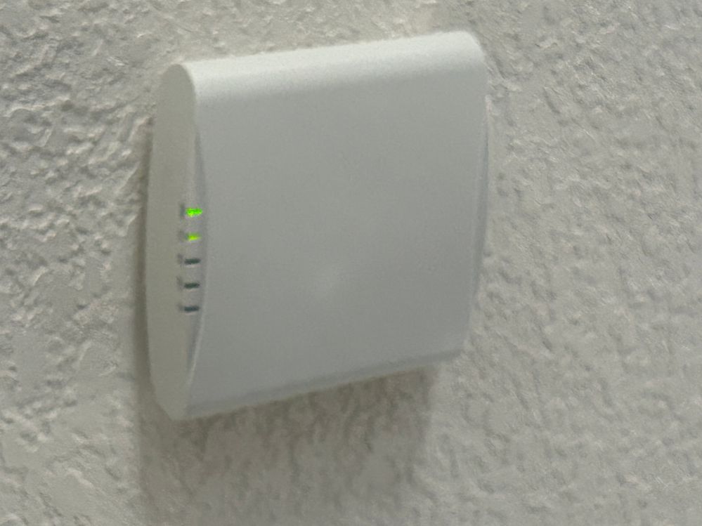

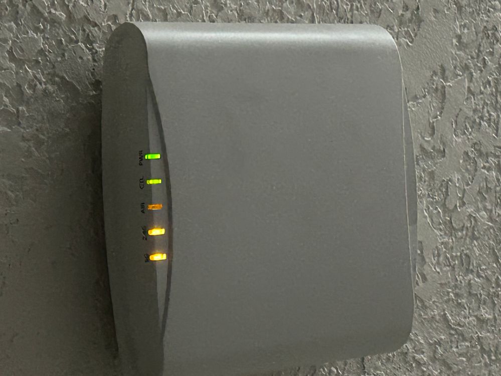

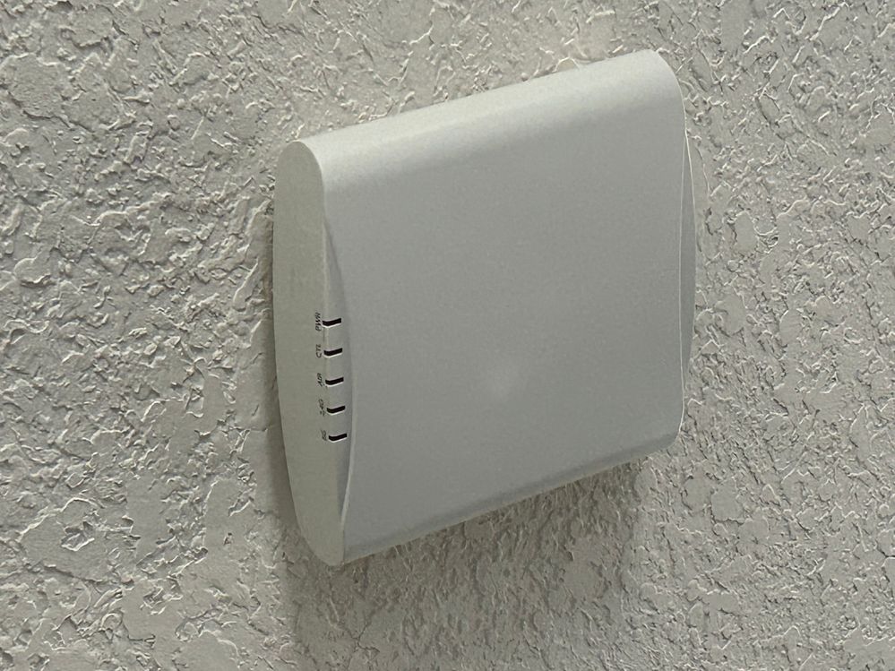

4. I have two Ruckus units, one on my main floor in my ceiling and one upstairs on my ceiling. Pictures are attached. Downstairs - the first two are blinking green
Some blinking
Downstairs - the two blinking green

From the Pictures I see the RUCKUS Switch and Access Points have normal light status.
Based on the picture you shared, it appears that the blue cable from your Internet Service Provider’s (ISP) router is connected to the incorrect port on the RUCKUS ICX-7150-C12P Switch. The cable should be connected to one of the 1-12 ports on the switch (please refer to the screenshots below). Kindly unplug the cable and reconnect it to the appropriate port. Afterward, please reboot the ISP router by unplugging and plugging it back into the power outlet. Once done, check your internet connection.
Please let me know how it goes, and feel free to reach out if further assistance is needed.
