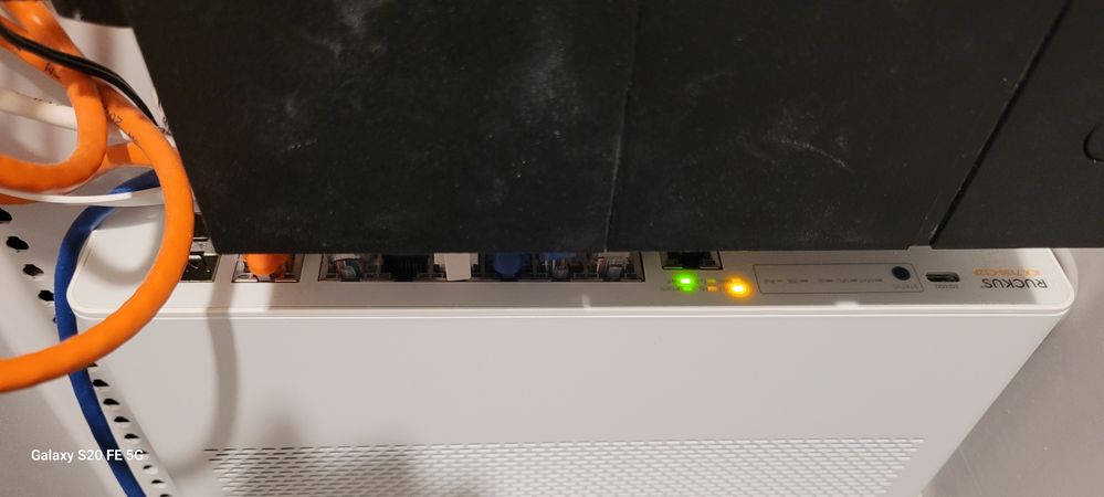

4. May I know how many Access Points are connected to the Switch? Could you please confirm if any of the status lights are ON (Please refer to the below picture and share a picture of the same)

It was working before, came home and I received a message from Ring saying it was offline. Noticed there were no lights on the access point, reset the Ruckus, still no lights. As far as I know there was no power outage.
The ISP is working and stable.

Thank you for sharing the information and picture.
From the pictures you shared, the status lights on the Switch is Amber and the Power lights is green, which means that the Switch is stuck in a boot mode
Please follow the below RUCKUS Lennar Knowledge base self-help article which will help you to fix the issue when the Switch is in boot mode.
https://community.ruckuswireless.com/t5/RUCKUS-Lennar-Support-Knowledge/Fixing-RUCKUS-Switch-with-an...
Please follow the process as explained in the article and let me know if you have any queries in this regard.
