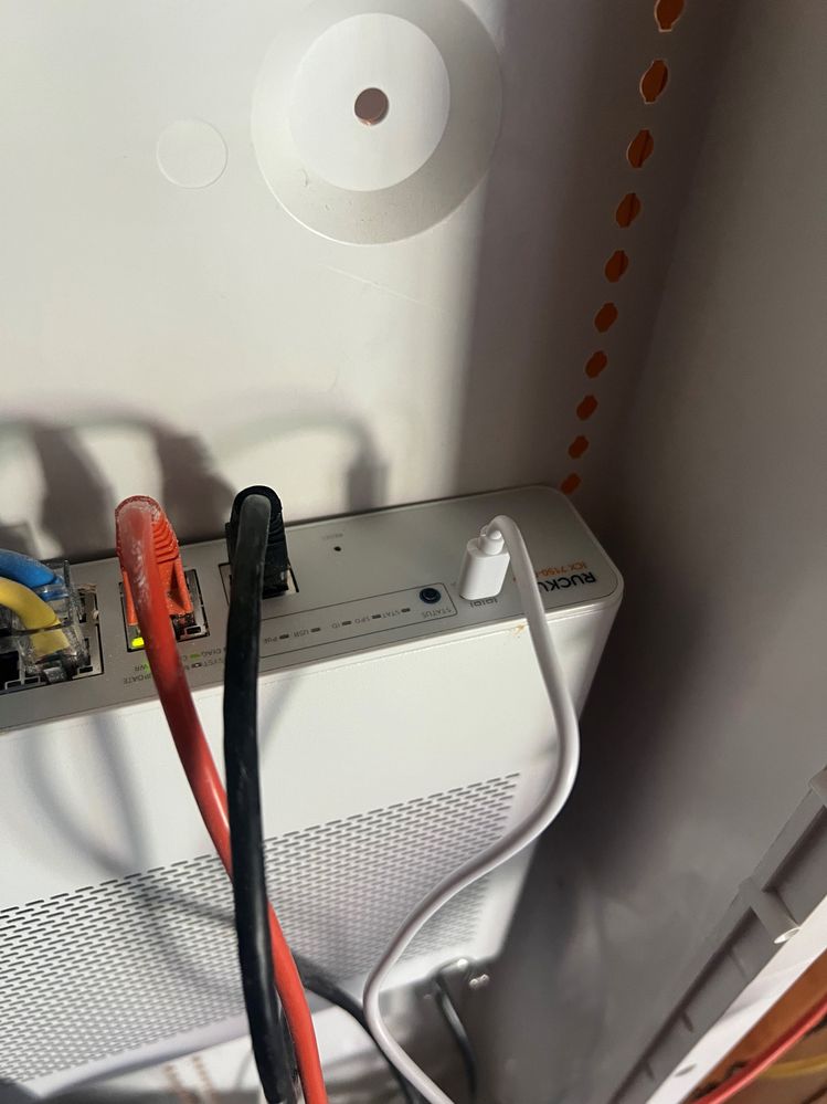

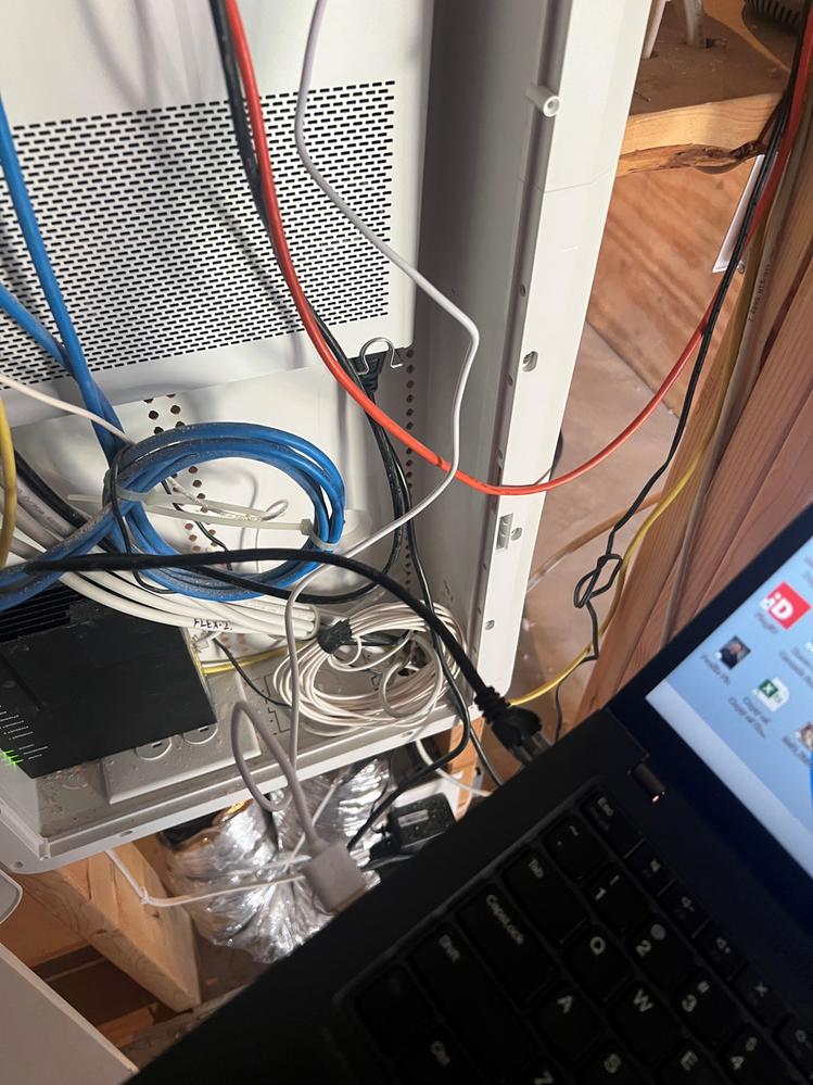

Hi, I have the Ruckus ICX 7150-C12P. My power went out last night and is now back. The access points however are still showing no power. All of the lights are off. the switch is showing power with both green and amber lights flashing. I have reset/unplugged 30 times etc but the access points still showing no power. The lights just keep flashing amber. Hoping there is a support number as I don’t want to do a system reboot. I have tried before on a comp and it didn’t work. More than happy to pay a service tech.

Could you please let me know the current status of the PWR and SYST LEDs on the Switch when it is connected to power?
Kindly confirm.
07-30-2025 01:56 PM
Green on PWR flashing amber on all other lights. Every time I reset it just flashes all lights non stop until I try and reset it again
