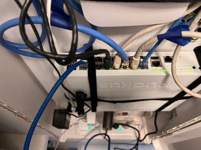

I reconnected the new Switch but I cannot connect to the configure.me wifi to continue set up. I think this is because the former owners still have their ID/Password set up and never reconfigured it. Please advise

Kindly ensure that all Ethernet cables are connected exclusively to the 12 designated ports on the RUCKUS ICX-7150-C12P Switch. From the picture you shared, it appears one of the cables is plugged into a non-designated port.

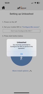

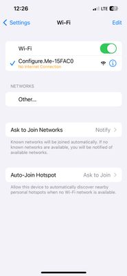

Thank you. I moved the ethernet to one of the 12 designated ports. And I performed the factory reset on the AP. However, when I attempt to connect to the configure.me wifi it says no internet connection and the ruckus unleashed app continues to give me the same failure message as before.

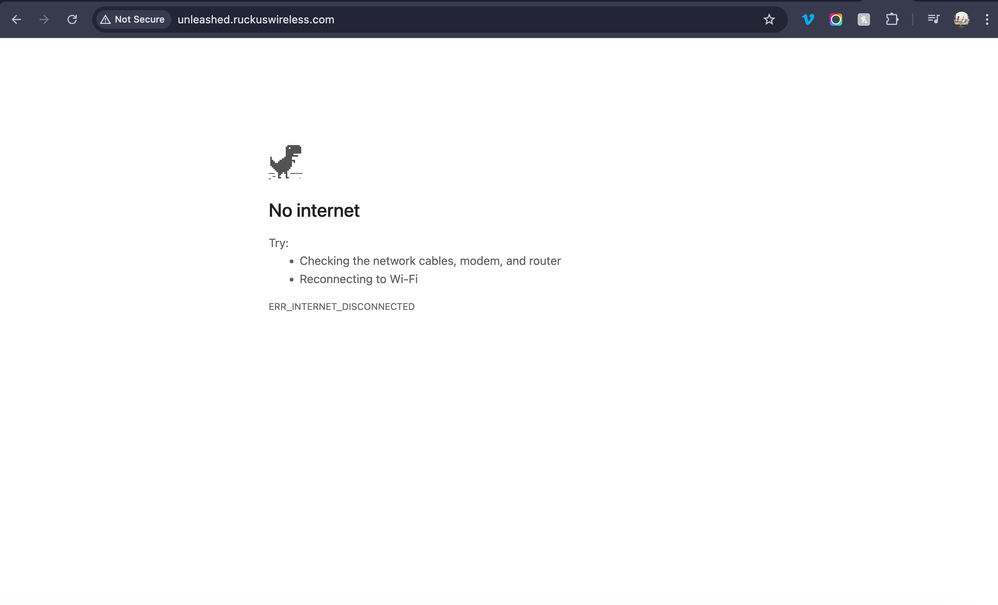

I attempted to do the reset from my laptop. I connected to the configure.me wifi and attempted to open the site (unleashed.ruckuswireless.com) however I kept getting a "no internet screen". I attempted to logon from a pc and it wouldn't allow me to open the site either.
