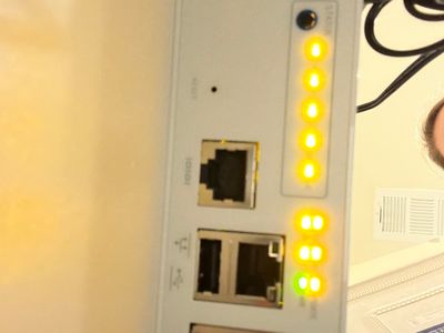

Title kind of says it all. I’ve reset a bunch of times.

Based on the information provided, it appears that you are encountering issue with the RUCKUS ICX-7150-C12P Switch.
it was previously operational before a power outage yesterday.
originally there was one green and one orange light. Now after I’ve tried to reset, the one green light is there and there are many blinking orange lights.

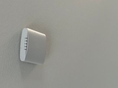

It does not appear that any of the lights on the access point are lit

Hi @Shanalee
Thank you for your response and confirmation.
An amber light on the SYST indicator typically indicates that your RUCKUS ICX-7150-C12P switch is stuck in boot mode and is not supplying power to the Access Points.
To assist you in resolving this, please refer to the following RUCKUS Lennar Knowledge Base self-help article for troubleshooting steps:
Fixing RUCKUS Switch with an Amber/Orange Light on "SYST"
As you tried to hard reset the Switch, please try it multiple times. If the reset with a paperclip works, the SYST and PWR lights should turn GREEN.
If reset doesn't work, the next step would be to perform the Software Recovery of the Switch as described in the above Knowledge Base article. Please follow the same and let me know for assistance at any step.
