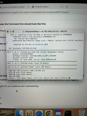

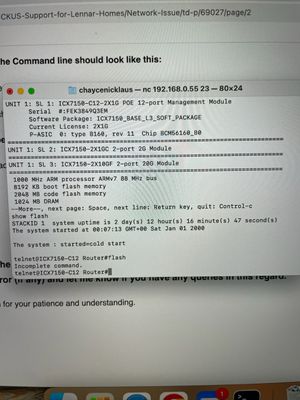

I was able to find the correct IP and access through the Mac terminal. Here’s what I had after entering the commands.

Hi @Chaycen
This issue is because your switch is running on the Routing code (SPR). The Switch should run on the Switching code (SPS) to avoid these issues for Lennar home users. Due to a power outage/power spike, the Switch boots up on the other partition which may be running on a ‘Routing Code’ results in causing this issue.
As I can see from the output you shared, your Switch is booted up on the secondary partition which is running on Routing code (SPR) as highlighted in the below screenshot.
Please Enter the below commands in CLI to fix this issue:

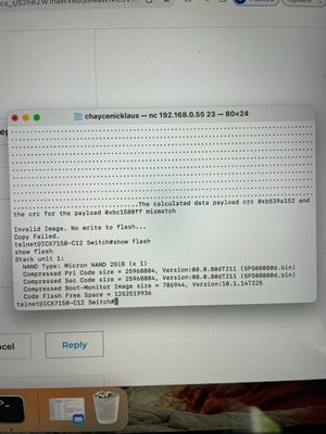

Could you verify if the process worked? The last command for the boot system flash secondary yes did not do anything in the terminal and a couple times I got an invalid image, no write to flash message as shown below. I ran the show flash again if you could verify it’s not in the secondary mode anymore.
Hi @Chaycen
Yes, now both the partitions are on the SPS code. (Please refer to the below screenshot)
Now your Internet connectivity via RUCKUS Network should be stable.
