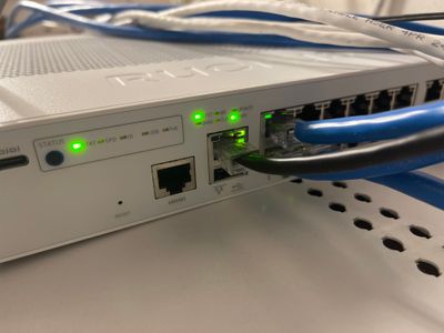

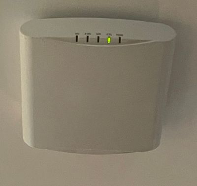

We have had issues with our internet over the last two weeks and had the internet people here all day last week. Finally have internet again but our ruckus wifi has gone away and now we just see recover.me and some numbers for our different connections. When I tried to connect onto the wifi it says I need a password. I have put in our password we created but its saying incorrect. I have tried to reset the box and this still continues to happen. Any ideas?

@imran_ruckus stat, syst and power are lit and then each of the 3 ports plus the one where our modem connects is lit green. We have had this working fine for 2.5 yrs and then a power outage happened 2 weeks ago and something happened with our internet and now the ruckus hasn’t been working. I have tried that password on the different wifis and none of them work. Before all the lights were up now only the first two and they are flashing. We have 3 other of these and they are doing the same.

Hi @Catiemthomp
As I see from the picture you shared, seems like the ethernet cable which is coming from the Router or Modem/Router combo is plugged into the wrong port on the Switch panel. As already described in my previous post device setup guide, it must be plugged into any 1 in-12 ports as shown in the below screenshot. Please unplug the ethernet cable and plug it into the correct port and try again.
Please confirm if that works or let me know if you have any queries in this regard.

Hi @Catiemthomp
This issue may happen when the Switch runs on the Routing code (SPR). The Switch should run on the Switching code (SPS) to avoid these issues for Lennar home users. If the Switch boots up on the other partition (Due to a power outage/power spike and you had a power outage recently) which may be running on a ‘Routing Code’ results in causing this issue. To check the same please follow the below process.
ICX7150-C12 Router> OR
ICX7150-C12 Switch>
show version
show flash
