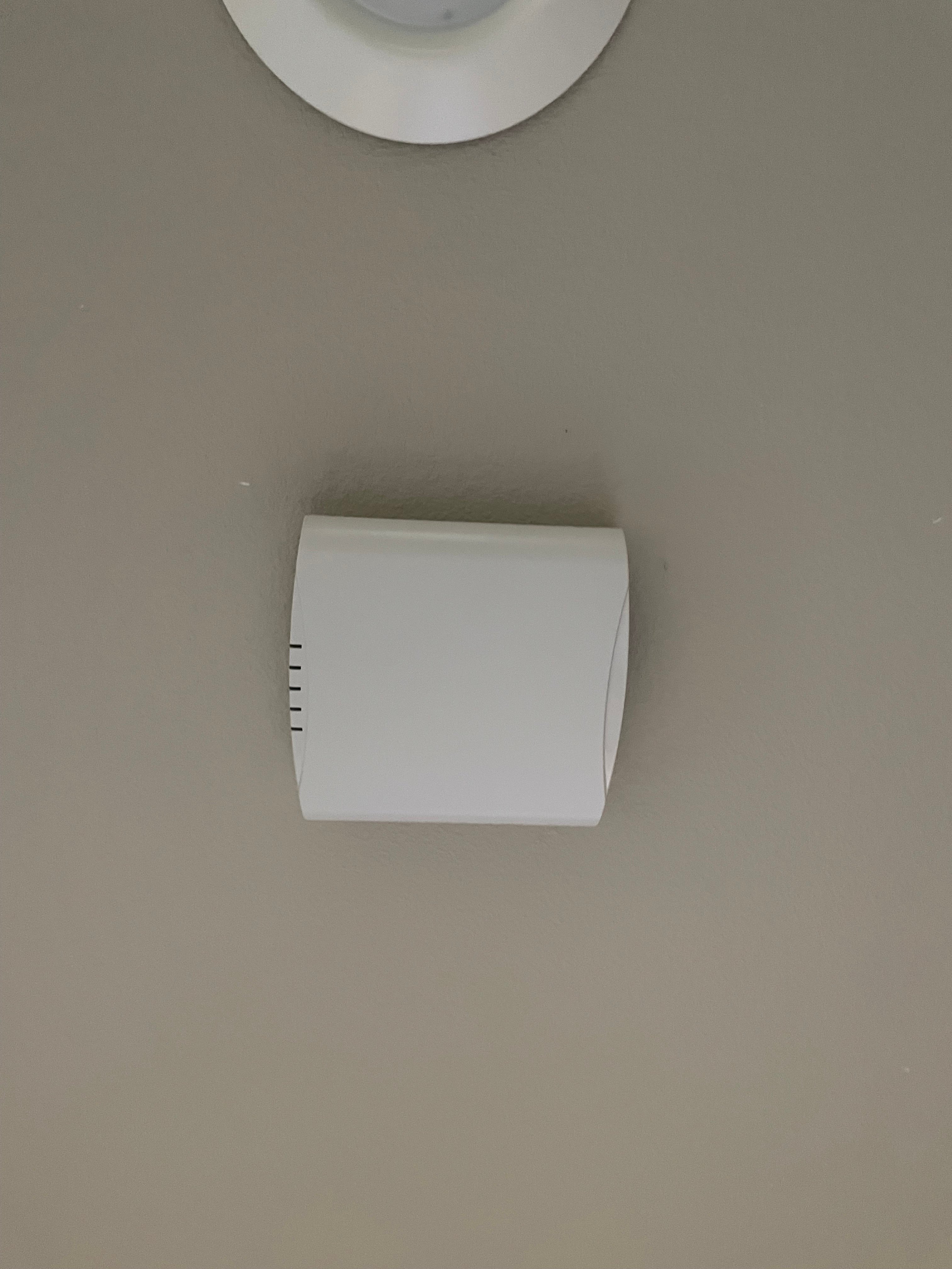

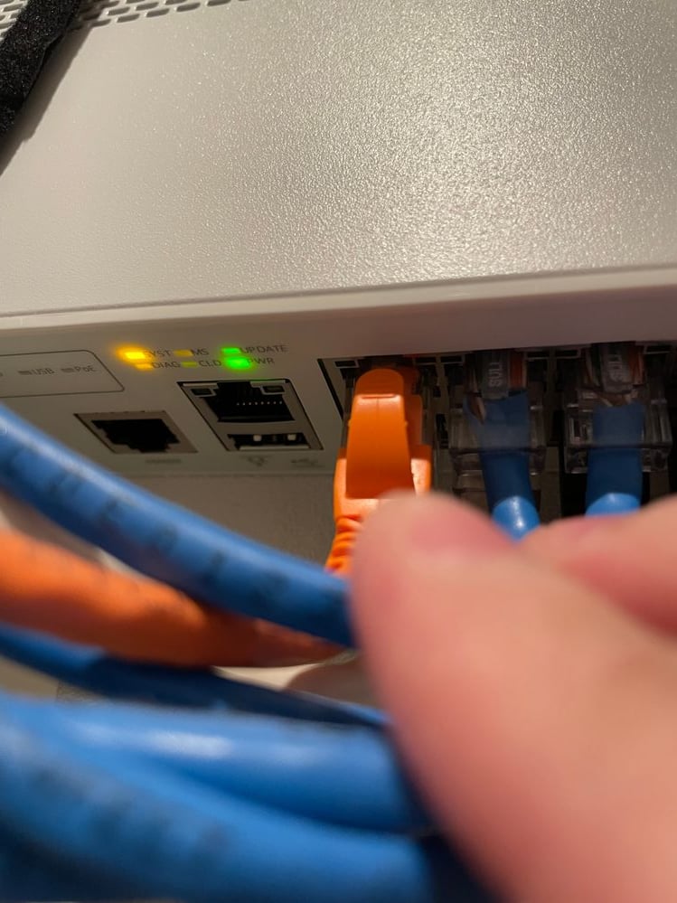

My Ruckus ICX-7150 -C12P syst light is yellow and ruckus indoor APs is not powering on (No wifi at home).
I tired following
For number 2, all the system LEDs flash more than 2 hours, and still flashing. Nothing how to fix it. Could someone help?

Based on your description your switch has one green and one yellow light, it means that the switch is stuck in boot mode.
If the resetting process doesn't work we need to perform software recovery process. Please follow the below link on how to perform software recovery process.
Here is the quick guide to perform software recovery.
