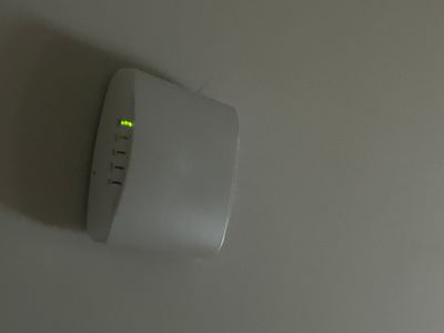

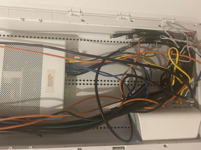

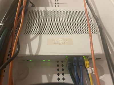

1. When your switch is connected to the outlet, do you observe any illuminated lights (amber or green)? Kindly describe which lights are visible. Additionally, please provide a photo showing the status of the lights and the full switch panel with cable connections to the switch ports.
2. Is your internet connection from the ISP stable and functioning? You can verify this by connecting to your local router's Wi-Fi or through an ethernet cable from the router to a laptop/PC.

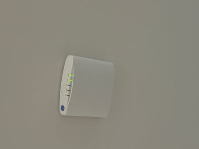

3. How many access points are currently connected to the switch? Please describe the status of the lights on the access points. Similarly, include a photo showing the access points' light status.
Please upload these photos to your RUCKUS account before proceeding.
08-30-2024 07:19 AM
08-30-2024 07:22 AM - edited 08-30-2024 07:24 AM
The first one is the main floor AP, the second one is upstairs. My Xfinity connection is working fine, but Ruckus WiFi completely disappeared. The Ruckus set up is at the garage.
