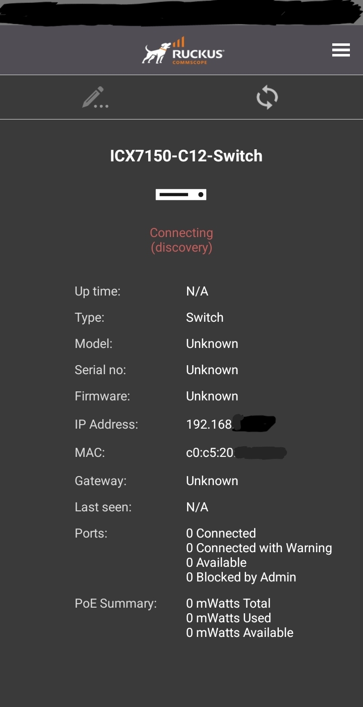

The only hiccup now, is I cannot see the switch configuration in my Ruckus Unleashed mobile app. It shows as not connected, Gateway IP unknown, 0 devices connected, which is not the case. It has an IP and pulled it from DHCP.

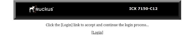

In fact, I have connected to it via http and putty (ssh) but it refuses every username and password attempt.
I have factory reset the device, but none of the known default username and passwords from the known list (another forum post I found) work. I tried all known associated passwords to "super" and to "admin" (for Lennar). Nothing works. Any help would be greatly appreciated.

As per the case description, I understand that you are unable to see the RUCKUS ICX-7150-C12P Switch in the Unleashed system.
Please log in to your Unleashed system on a LAPTOP WEB BROWSER using the Master AP IP Address OR https://unleashed.ruckuswireless.com/ to upgrade the RUCKUS Unleashed Access Points.
Steps to synchronize the Switch (ICX-7150-C12P) to the unleashed Access Points:
Switch side:
Make sure the management approval is enabled.
Access Points (unleashed) :
On the Unleashed dashboard
1. Remove the existing Switch from the Unleashed (Please refer to the below picture):
2. Hit Add on that dashboard
3. Put the IP address of the ICX switch (ICX-7150-C12P) and Username/Password–
4. Username and password for Switch authentication are the same as what you use to log in for Switch on Web or CLI (Putty).
To sync the data, it will take us a while, so after a couple of minutes, it should say connected.
Once the Switch gets synchronized, please check the dashboard again.
