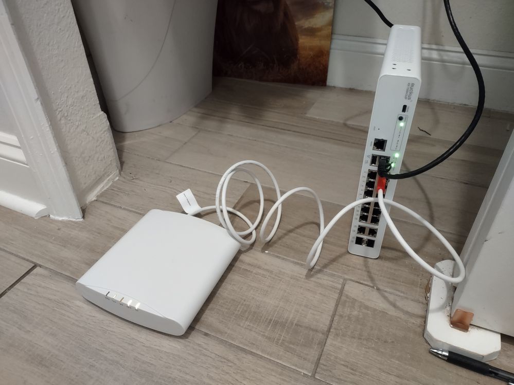

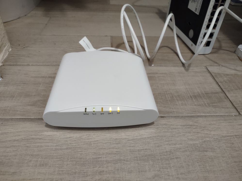

3. May I know how many Access Points are connected to the Switch? Could you please let me know the light status on the Access Points? Any of these lights are on (Please refer to the below picture and share a picture of the same)
Please let me know the answers to ALL the above queries and let me know if you have any queries in this regard.
03-01-2024 05:57 AM
Good morning,
Please see attached pictures and answers to the above questions. I have verified that my ISP connection is good to go. I have connection with all other devices in the house via WIFI and wired connections. In the attached photos I removed the switch from the cabinet, disconnected all other devices and was testing just the access point to see if I could get it work while eliminating any other devices which could be having issues that could be causing it to work incorrectly. Even in this setup I was not able to get the access point to work, still got the IP CONFIGURATION FAILURE. Additionally, I ran an ethernet cable from the none PoE port to one of my old computers, and connected my normal internet (ISP) connection from the AT&T modem. I put to default IP address 192.168.0.1 in and was able to access the switch but was still not able to get it to work. I also checked my smart home manager app through AT&T and can see that my switch shows online. I hope that information and photos helps. Please let me know if you need any other questions answered. Thank you for the assistance. Oh and I have to access points in the house, both are R510's, I have tried to factory reset both and they both came back with the same issue, IP CONFIGURATION FAILURE. This was done multiple times via phone and laptop with each and no dice.
03-01-2024 06:16 AM
Hi @ajdj810
Could you please let me know, from where the Black ethernet cable connected to the Switch is coming from?
Please confirm.
03-01-2024 06:53 AM
Good morning,
The black ethernet cable is coming from port 4 on my ISP modem in the cabinet.
