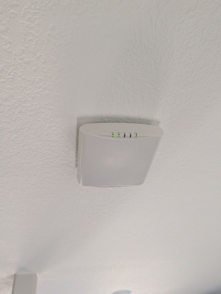

My internet went down yesterday and I have tried resetting everything but still not internet. The PWR, 2.4G, and 5G lights are all on and green but the CTL light is off.

Hi @Caliendo
Based on the information provided, it appears that you are encountering internet issues via RUCKUS Access Points.
Please note that the CTL (Controller) LED will be illuminated only on the Master Access Point, indicating that it is operating as the controller in the Unleashed network.

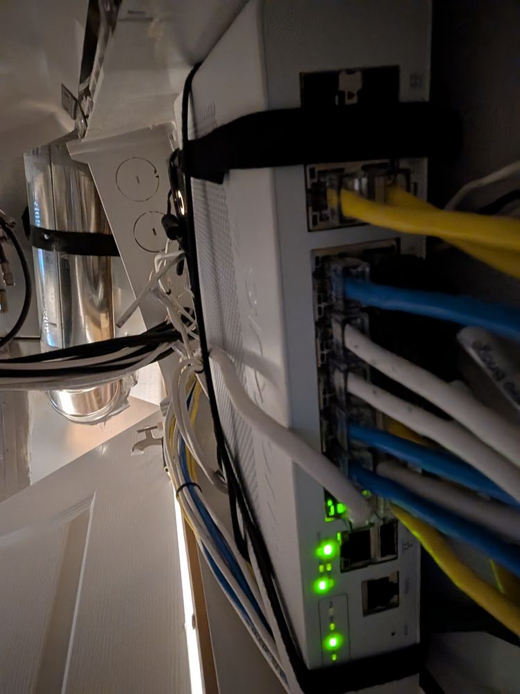

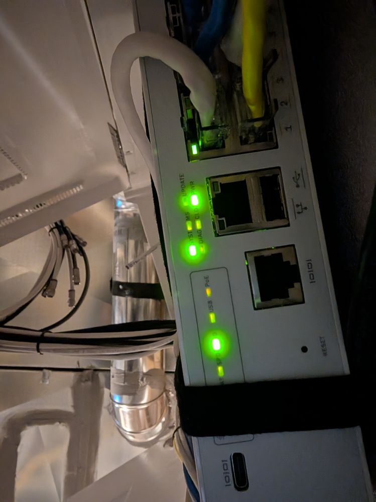

Caliendo
No there were no power outages
See pictures below
Yes it is
See pictures below

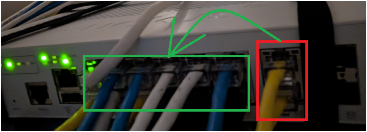

Hi @Caliendo
Based on the current LED status, the RUCKUS Switch and APs appears to be in a normal state. However, please try unplugging the Access Points (AP) Ethernet cables and Internet Service Providers (ISP) cable from their current switch ports and reconnecting them to ports within the 1–12 range (refer to the screenshot below). Once completed, please check the internet stability.
A close up of a network switch
Additionally, I noticed that two cables are connected to other ports. These should also be connected within the 1–12 port range. Please refer to the screenshot below for clarification.
Let me know how it goes.
