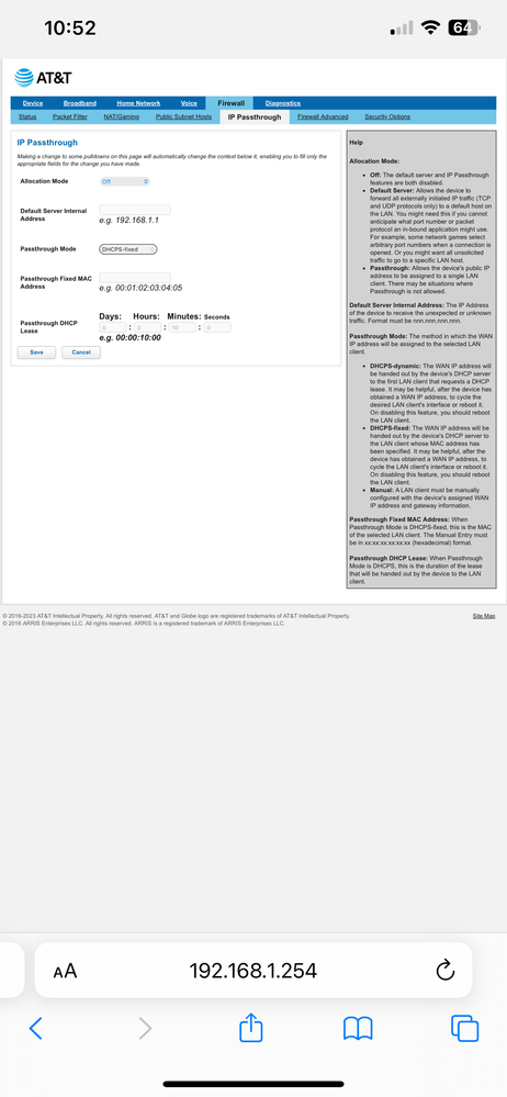

Could you please log into your AT&T account and share a screenshot showing the below information?

Imran,
See below
