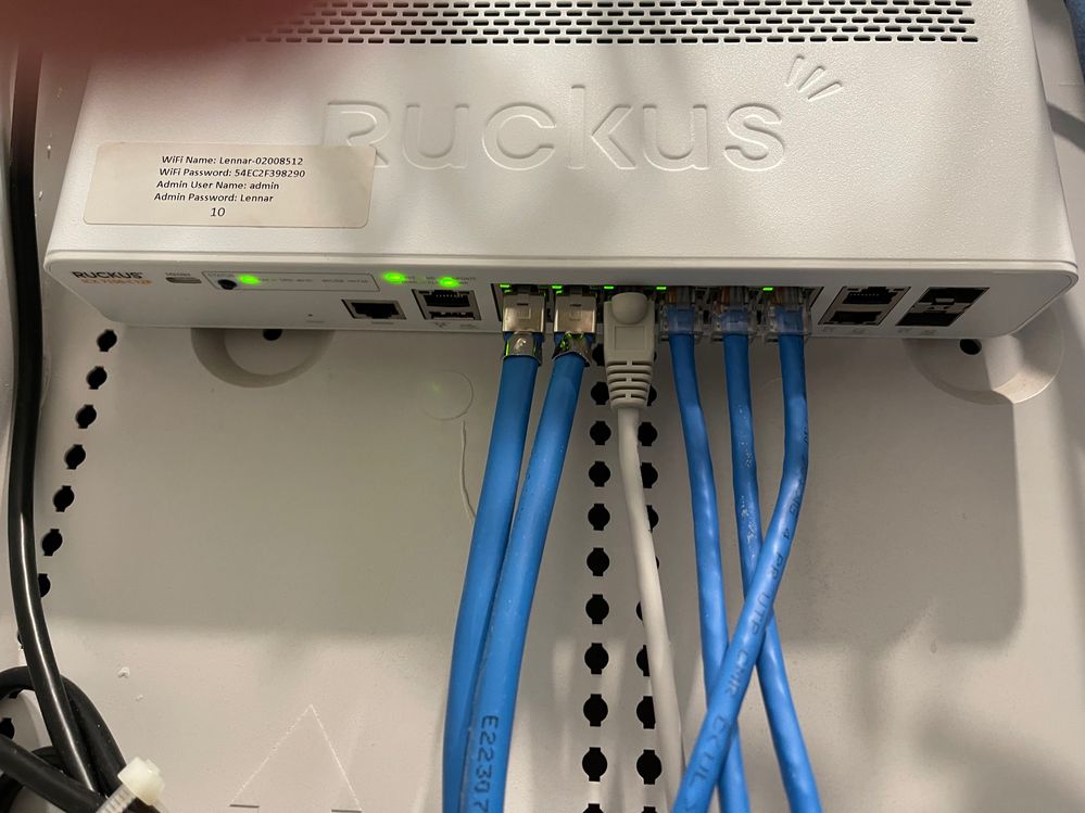

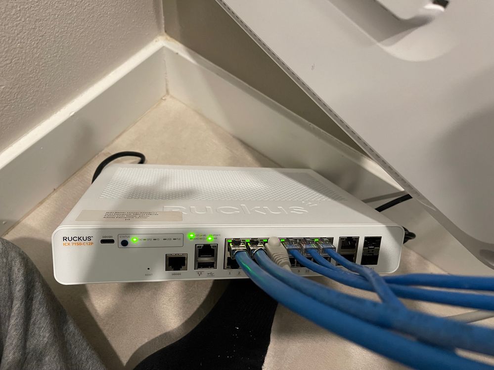

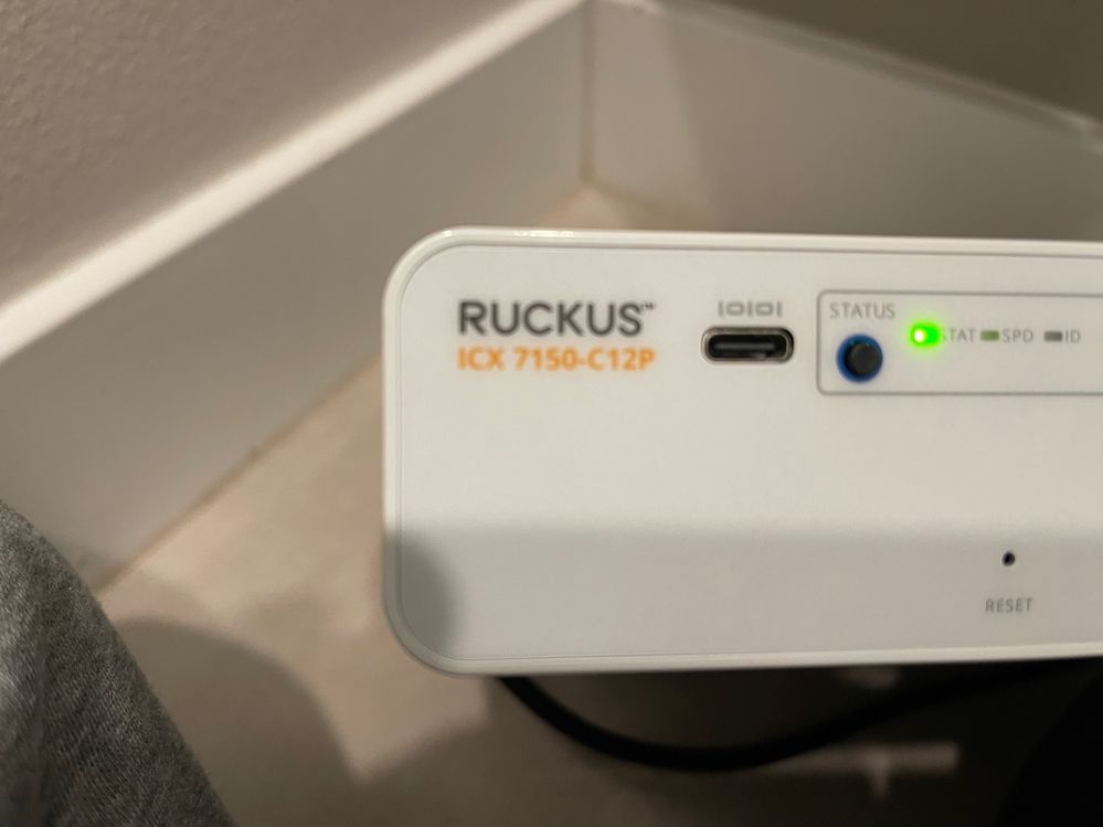

1. On your switch while it's plugged into the outlet, do you see any lights on? (Amber or green) Please let us know which lights are on. (Please refer to the below picture and share a picture of the same showing the light status and port connection to the Switch)
2. May I know how many Access Points are connected to the Switch? Could you please let me know the light status on the Access Points? Any of these lights are on (Please refer to the below picture and share a picture of the same)
Please help us with pictures of your ICX-7150-C12P Switch showing the status of the lights. Also, light the status of Access Points.
Please let us know the answers to the above queries or if you have any queries in this regard.
1. we see that all lights are green
2. we see 6 lines connected.
Hi @sparkedw
As per the light status of the Switch and the Access Point, they seem to be in a normal state.

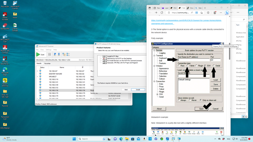

This issue may happen when the Switch runs on the Routing code (SPR). The Switch should run on the Switching code (SPS) to avoid these issues for Lennar home users. If the Switch boots up on the other partition (Due to a power outage/power spike) which may be running on a ‘Routing Code’ results in causing this issue. To check the same please follow the below process.
ICX7150-C12 Router> OR
ICX7150-C12 Switch>
show version
show flash

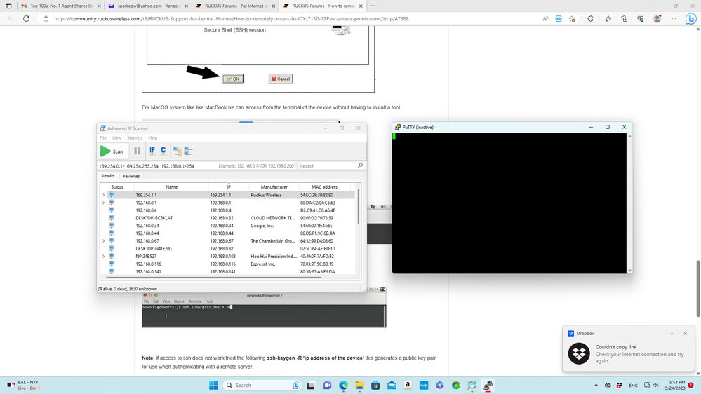

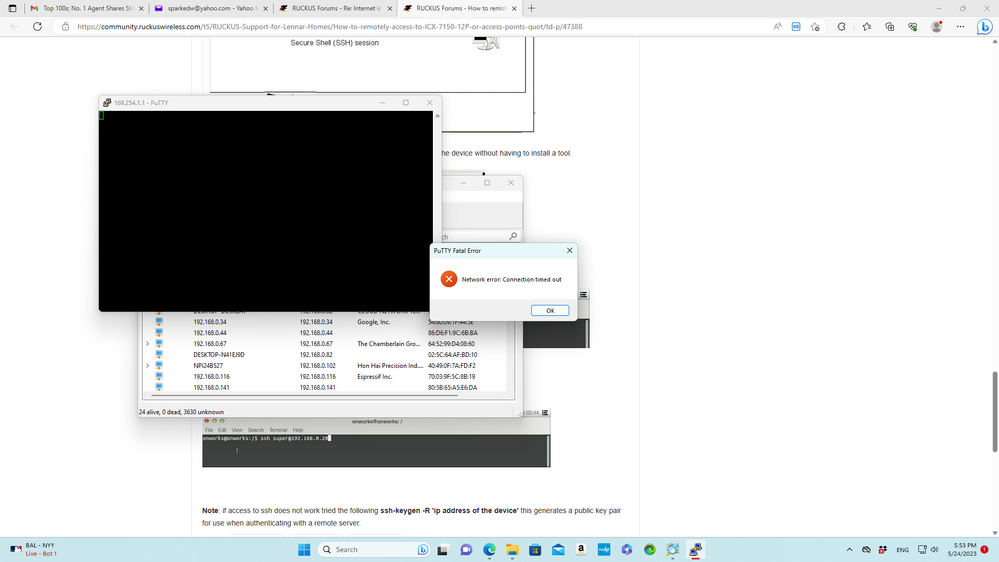

i don't know what to do from here. i keep pasting the IP address that i found from the first installed app and a black box just keeps popping up with that error message
