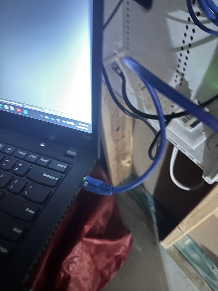

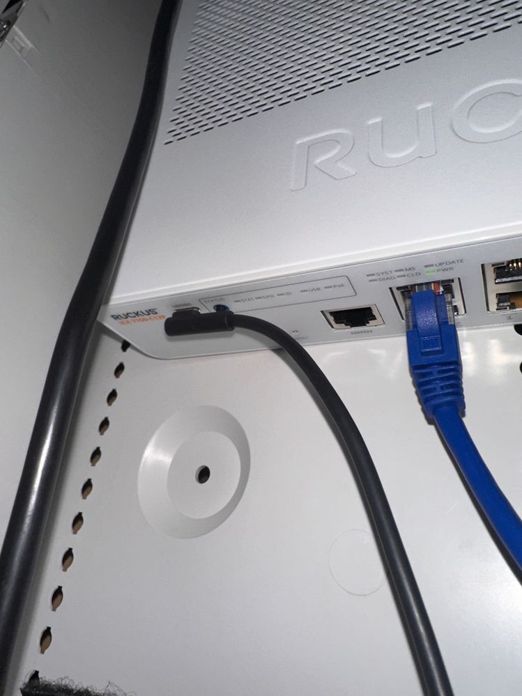

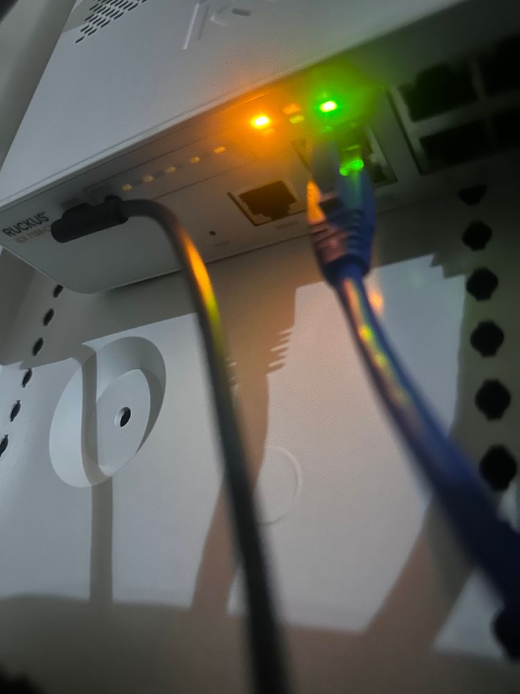

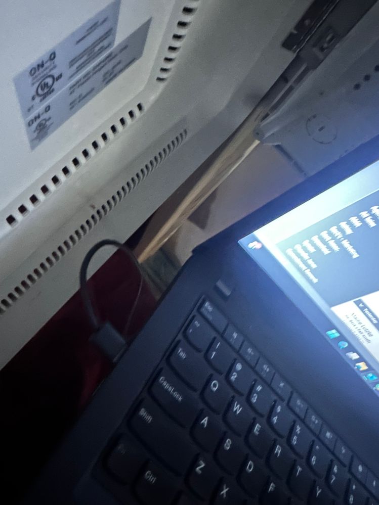

Could you please let me know at which step of the Software Recovery process you are currently stuck? If there is any error, kindly share screenshots for reference.
Additionally, please provide a picture showing the Software Recovery cable connections between the switch and the laptop.

I followed the directions to a T. I had support from an IT person I work with and they followed all instructions and everything was implemented as it was provided. The only somewhat error we saw was something like "bad block at 0x05a0000" I don't know if those were the exact numbers.
