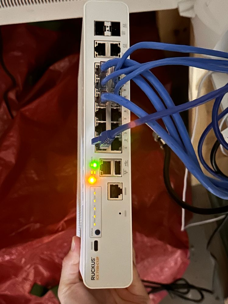

My ICX 7150 stopped sending power to my 3 AP's. I've followed several help forums and have done hard resets (unplugging and holding the reset button for 10s) and the AP's have yet to power back on.

2. When your switch is connected to the outlet, do you observe any illuminated lights (amber or green)? Kindly describe which lights are visible. There are two lights one is green under PWR and other is amber on SYST.

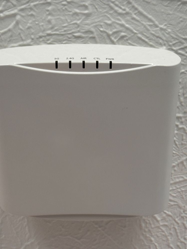

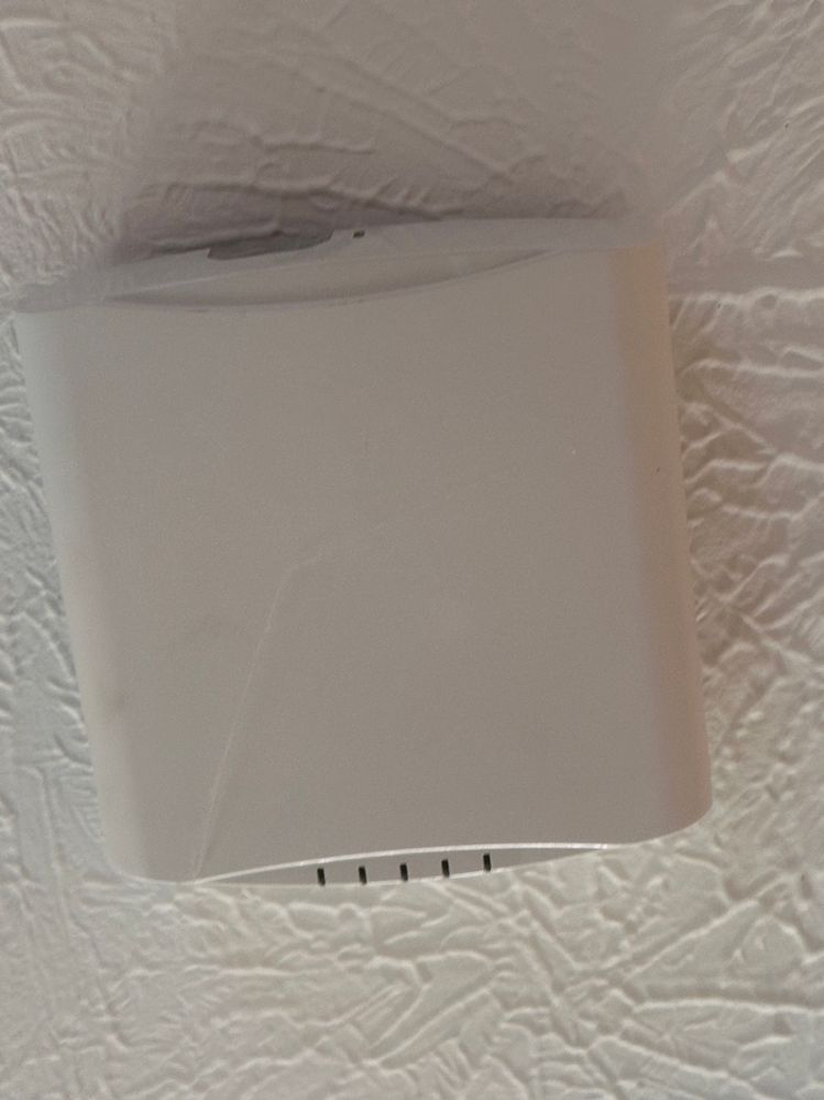

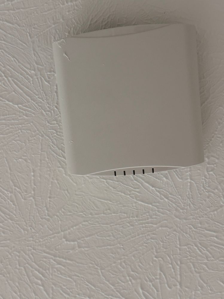

3. How many access points are currently connected to the switch? Please describe the status of the lights on the access points. Similarly, include a photo showing the access points' light status. There are 3 access points connected to the switch. They all 3 have no lights on at the moment. Photos are uploaded.

From the picture you shared, I can see that your switch has an Amber/Yellow SYST LED, which indicates that it is stuck in boot mode.
As you already tried, could you please try performing a hard reset using a paper clip a few more times (30-40 times approx.)? If that does not resolve the issue, the next step would be to perform a software recovery on the Switch.

09-17-2025 02:01 PM
Hello,
I tried both of these methods and I'm seeing the same result.
