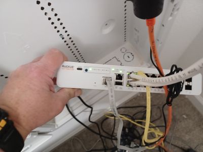

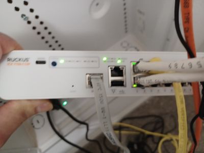

Hi @09stanggt ,
As per the case description, I understand that your RUCKUS setup is not working and is rebooting intermittently.
Please refer to the below picture and share a picture of the same, showing the light status and the FULL Switch panel cable connections to the Switch ports)

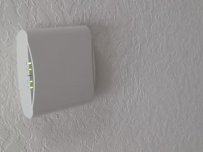

Hello @09stanggt ,
We haven't had to reboot yet this week, although we're about due. Prior to the last reboot the only thing I could find which I thought could possibly impact everything was that the time/clock in the switch was off by almost 3 years. I set the time but we still had the same issue less than a week later. Maybe it has sorted itself out?
If we do need to reboot I'll make sure to take some pictures and post.

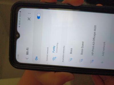

Ok, currently neither phone can connect to the APs. My laptop currently has internet but can't reach ruckus unleashed site. Let's clarify the problem.  It's not rebooting itself, we have to or we'll have no internet.
โ€ƒ
