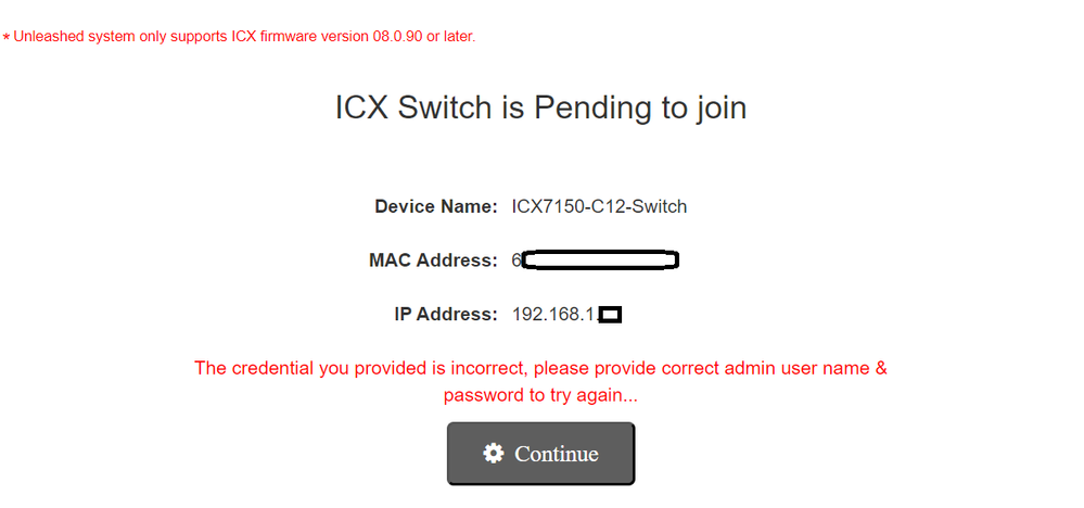

But the switch doesn't seem to join the Unleashed network. Both the APs show connected and display information
On the Unleashed UI, I see the Switch as "Pending" with the message
The credential you provided is incorrect, please provide correct admin user name & password to try again...
I'm assuming that a typical upgrade does not wipe out credentials?
How can I get past this state for the switch.

We need Switch credentials to add Switch to the Unleashed. We will have to reset your Switch credential to get CLI access and perform the commands:
For reset of the Switch credentials first, we need to get consoled access to the Switch. Please follow the below process for the same.
