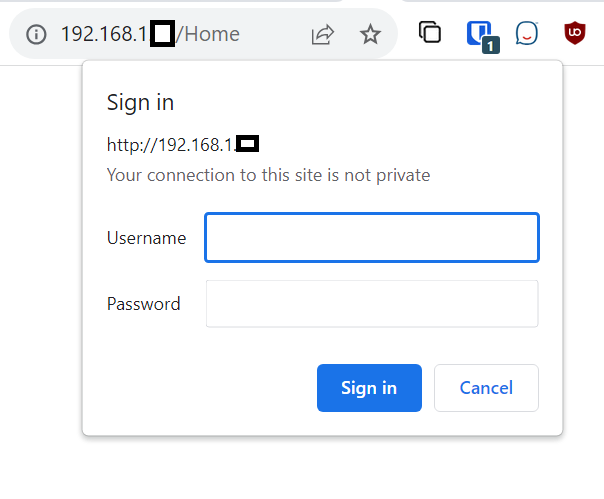

Hi Imran, When I click on the login link on the "Login" link on the Switch dashboard, I get a basic authentication prompt which doesn't accept the previous system password.
I've tried a serial connection using a USB-C cable to the switch and see the same issue when trying to access the privileged EXEC mode
ICX7150-C12-Switch>
ICX7150-C12-Switch>enable
Password:
Error - incorrect password.
I assumed that the password to be used is the same in both cases. Please let me know if that is not the case.
How can I reset this password...can I do it using the CLI?
