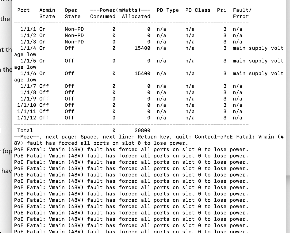

My ICX 7150 is stuck and cannot provide Poe
When trying to do a factory reset, nothing happens.
When connecting to console (through MacBook), the switch says:
Vmain (48V) fault has forced all ports on slot 0 to lose power.
i then try to go in boot mode to do a software recovery. I setup the Mac in TFTP. It is listening and permissions have been updated.
the console returns the following.
bcm_xgs_gmac-0 Waiting for PHY auto negotiation to complete......... TIMEOUT !
another option I can try is to wipe the switch and boot from usb. Would this be my recommended next step? If so, how?

Based on the troubleshooting done, and you confirm after the reset and booting up the Switch, the failure still persists with an error “PoE Fatal: Vmain (48V) fault has forced all ports on slot 0 to lose power.” this unit Should be RMA (Return Merchandise Authorization) in simple words replacing it.

As per the case description I could understand that your ICX-7150-C12P Switch is stuck, and you tried doing a factory reset and software recovery which did not work,
You don't need to follow the Software recovery guide (this is done when the switch won't boot, or the images get corrupted)
In your case, it may be that the PoE (Power over Ethernet) can be disabled/corrupted/damaged.
Could you please perform the below commands and send us the output for the same?
#Enable
#show version
#show inline power
#show inline power detail
copy flash flash secondary (optional for Routing code issue) – Just for a reference

02-01-2023 09:25 AM - edited 02-01-2023 09:59 AM
Thank you Imran_ruckus,
I have attached them below.

next line: Return key, quit: Control-cPoE Fatal: Vmain (4
