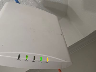

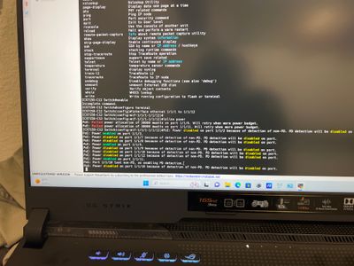

We lost power both APs aren’t receiving power after power returned. I have Reset all items several times APs and switch. I have switched cables where possible. I have attempted reboot using coms port that didn’t accept a boot load, flash attempted but failed. Boot said invalid. Not sure what I could do here.

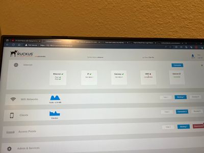

I need also need help recovering my ap the current password is not being accepted.

Please try to use the default combination credentials as mentioned in the link below to login into Unleashed.
Please follow the below process to Upgrade your Switch.
The recommended stable version is 8095g (08.0.95g).
The Upgrade path would be 08061a>>8080f>>8095g
Below are the options or methods to perform the Upgrade on the switch: You could choose any one of these.
1st Option:
1. In this option, we will use a pen drive or USB flash drive in which we move the files to the pen drive and connect it to the Switch then through CLI we execute the commands to upgrade the Switch using the following guide as a reference:
2nd Option:
2. The following guide is an example of an upgrade via TFTP server, by using an application (FREE) to send files or upload remote files to a device, in our case, we will use it to update a new version to the Switch, basically it will send the image version remotely from the computer to the switch.
3rd Option:
3. In this option we Upgrade the Switch from the Web Interface (GUI) of switch.
As you can access CLI, I would suggest you follow the 2nd option.
Please share the screenshots if stuck at any step or error (if any) and let me know if you have any queries in this regard.

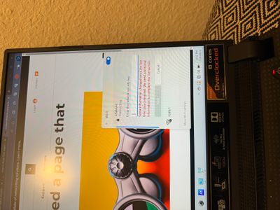

I am need more information on resetting the network password. I am not currently able to access the network and figure out how to navigate to the right page in unleashed
