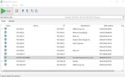

Hello, I had already tried to locate the IP address following this process before and I did not see it, I am assuming it is not putting out a WiFi signal. However, I tried again as instructed since you told me that I had the cable from my service provider connected to the wrong port ( I am still not sure if you are right about that as I had it in the same port it had been connected to prior to the issue i am having now when everything was working correctly, but I changed it to the port you instructed me to anyway) I still do not see an IP address for my Ruckus. See below
01-02-2024 09:15 AM

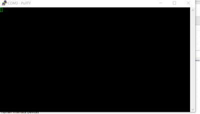

I had already done all of this FYI by looking through the forum before I created my own support thread. However I just tried again.
When I console in it does not bring me to either of these Command lines
ICX7150-C12 Router> OR
ICX7150-C12 Switch>

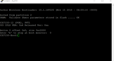

mine is blank, see below
However, if I hit the reset button with a paperclip and enter "b" when it gets to the boot monitor step I can get the boot command. This is where I attempted to perform the software recovery using instruction found in the forum which resulted in the dialogue that I had shown you in my very first post above after I completed all of the recovery steps.
