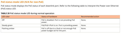

Hi Mess, I'd try:
1. Replace the Ethernet cable
2. If available, connect another AP
3. From switch CLI doublecheck PoE status with "show inline power"
I'm afraid this could be an AP hardware failure.
Image_ images_messages_5f91c45b135b77e247a414ba_c68577f80080f2893e1b11500c30c6d1_RackMultipart2020060112719930m-3dbf7fa4-a3c2-487d-9b1b-531f8b16181d-267973564.png1590995984
