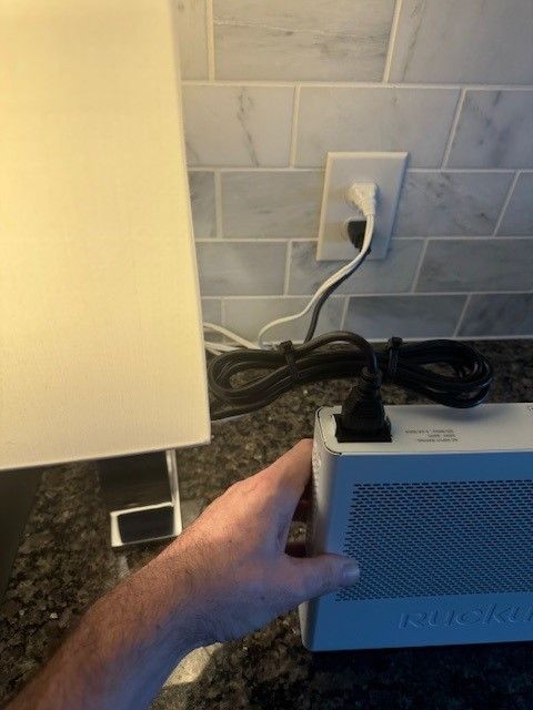

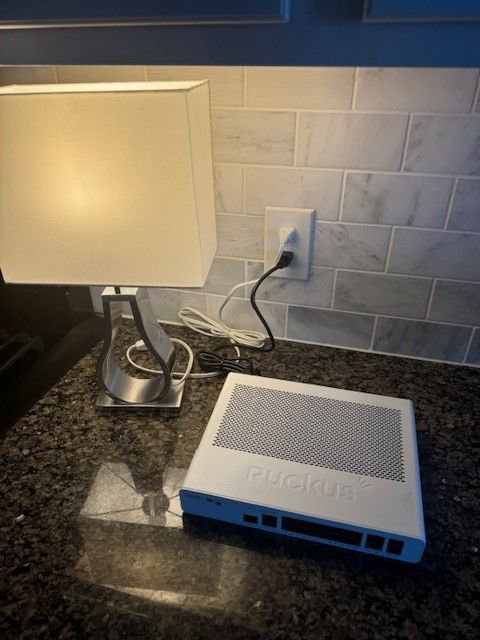

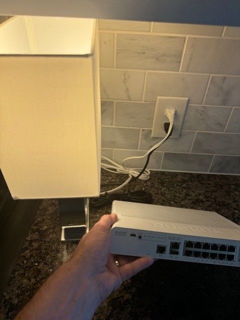

without any indication or power surge my ruckus ICX 7150 C12P lost power and no longer functions.
Both ceiling extenders are completely down as well.
I still have active Wi-Fi through my router/provider.
Everything is plugged in correctly.
When resting power supply, lights blink for 1/2 second and then go out.
Yes, I have tried the factory reset several times with no luck.
Pleased advise
Thank you
Jelle

07-29-2024 11:52 AM
Pictures and Video have been uploaded to Google drive link
Thank you
Jelle
07-29-2024 12:04 PM
Hi @JelleV
Greetings of the day!!!
Thank you for sharing the requested PICTURES and a VIDEO.
Based on the troubleshooting done, your ICX-7150-C12P Switch is not powering up, and when plugged in, it flashes an amber light and then goes dark. You confirmed that the Switch is plugged into a well-known outlet/power source and tried hard reset. However, the failure persists. This Switch unit Should be RMA (Return Merchandise Authorization) in simple words replacing it.
