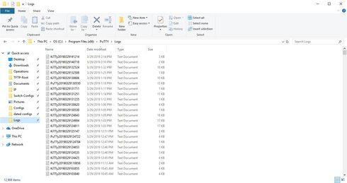

I am fairly certain your computer issues are unrelated.
Here is an example of all the log files (12,908) I have saved over the years:
Image_ images_messages_5f91c476135b77e247aa1b7e_9bc68db6ef8720cf87485eb8bb03755c_RackMultipart2019032931029irpu-f5ef9f10-8ab5-4f8a-8566-e5087c10ec9c-420830660.jpg1553883632
Believe me, if PuTTy or Kitty, a console port, or SSH session was going to mess up a computer... long before now I would have had issues.
