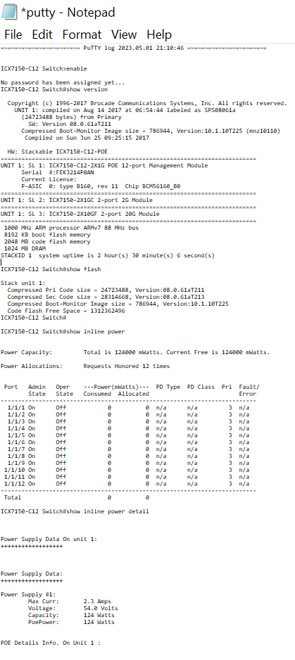

I did not have any cables connected.
I ended the putty session and went back into the console port.
It shows that I have POE turned on despite the previous messages.
I plan to reinstall the RUKUS into my network after I get current on firmware.
Please direct me. I am ready to go ASAP.

05-01-2023 06:28 PM
I think I am fixed. Ready for firmware upgrade instructions.
