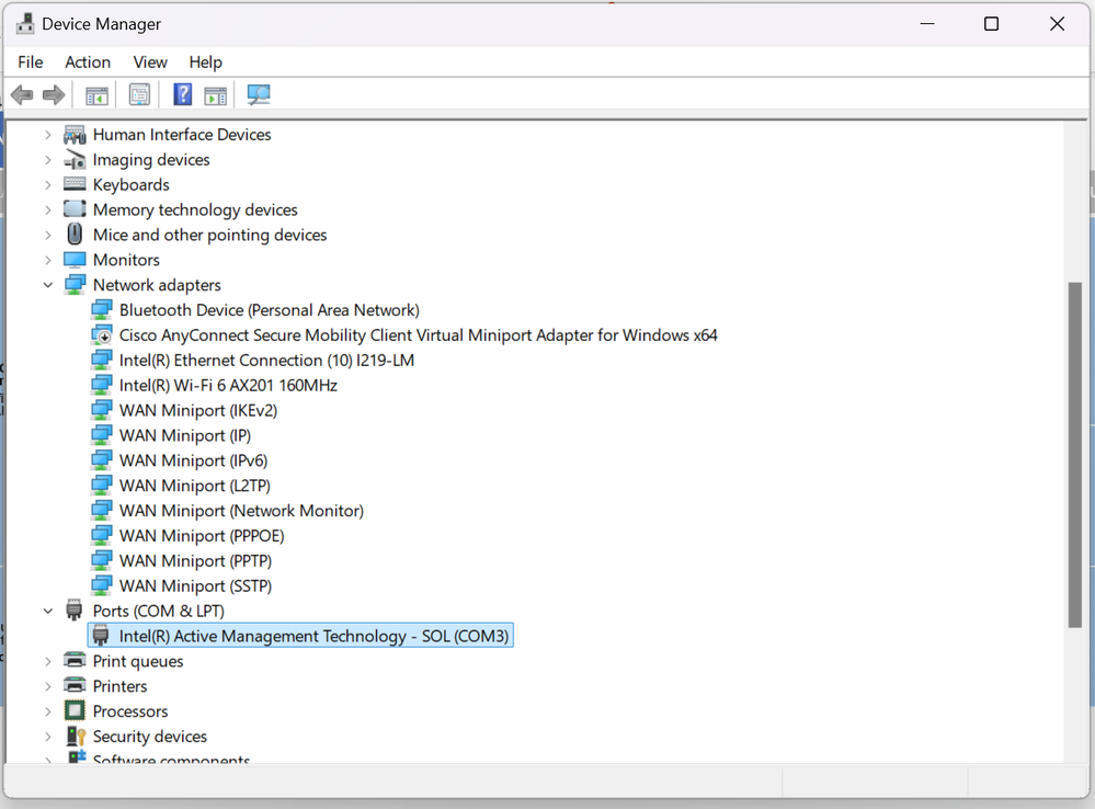

Could you please restart the laptop after installing the drivers and check the COM port details in the Device Manger from the Control Panel?
COM port details should be with the silicon lab name in the device manager.

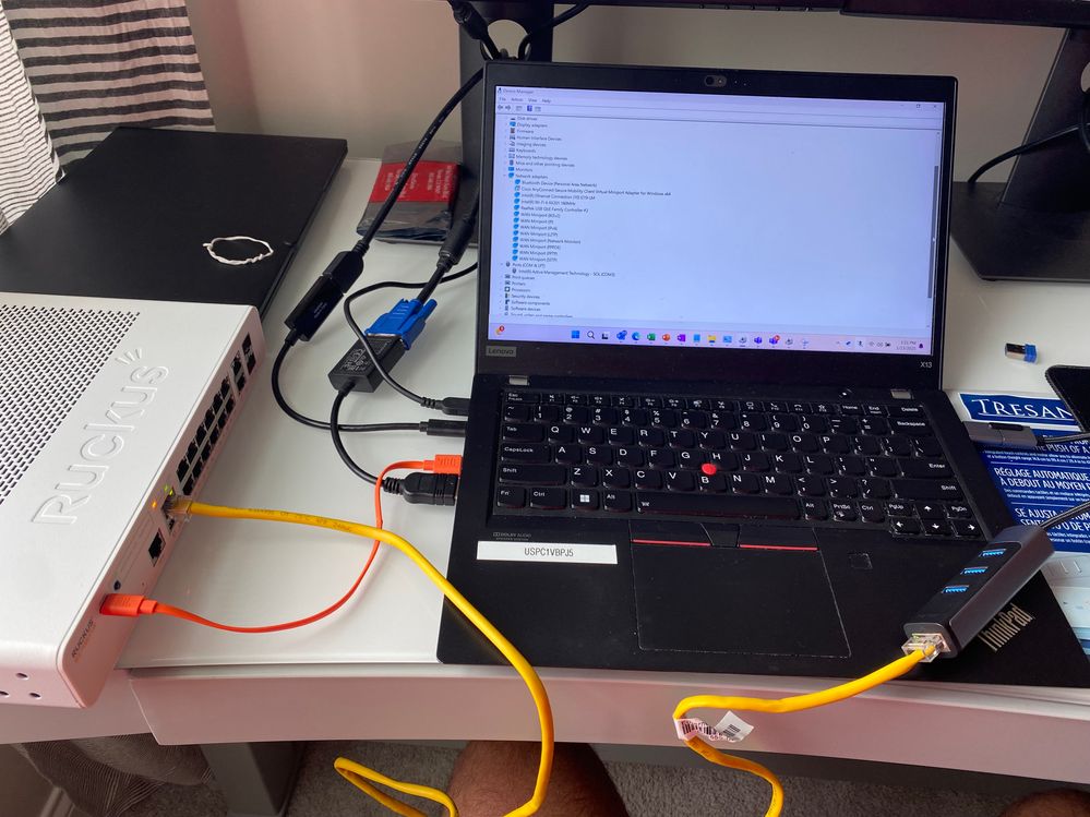

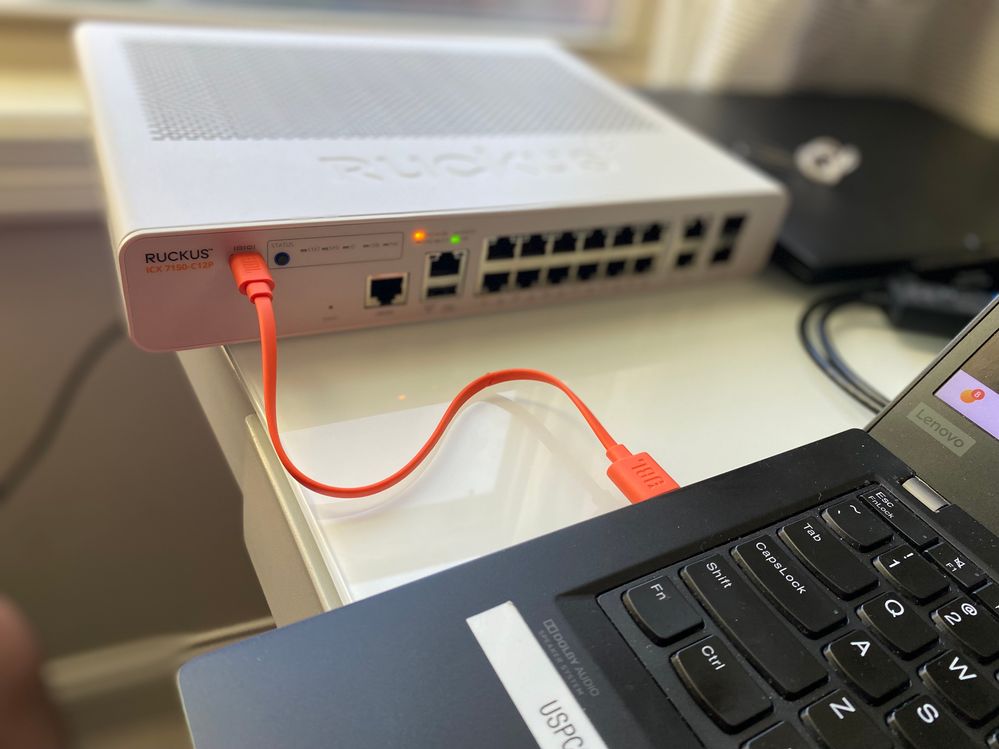

Also, could you please share a picture of the software recovery cable connections between Switch and laptop?

I tried both the steps earlier and I dont see the COM port details with silicon as suggested. Secondly please find the attached pictures for reference of device manger and other one also as requested .

Based on the troubleshooting done, your ICX-7150-C12P Switch is stuck in bootmode and tried to complete the software recovery. However, you were unable to complete the software recovery as you were unable to install the drivers. This Switch unit Should be RMA (Return Merchandise Authorization) in simple words replacing it.

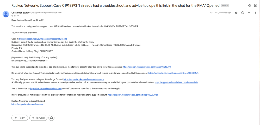

Thank for the details and helping with the RMA. As suggested I completed the process for the RMA and support case number is generated - 01918393. Please let me know how many days it will take to get the new switch as an RMA for the serial number - FEK3820R0WA ?
Kindly refer to the snapshot and please share the estimated device delivery date.
