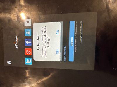

Hi Imran,
I tried all passwords you listed, and each were exactly as shown, case sensitive, however, none worked. I previously had a login when they first set this up, the error it gives me now with the old login is the same error I received trying the combos you provided.
I go to the settings and it shows I’m connected to the local network. There is a hyperlink for “change, login, destination“, if I click that it shows the destination IP as unleashed.ruckuswireless.com is this correct?
Hi @Rspinks0518
Could you please try to login using the same default usernames/passwords on a laptop web browser using Master APs IP address or https://unleashed.ruckuswireless.com/ ?
Please check and confirm.

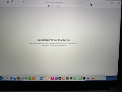

I have a MacBook that runs on IOS and when I go to the website you provided I get the below.
Hi @Rspinks0518
Could you please try to find the IP address of the Access Point using an LanScan IP scanner and try to access?
