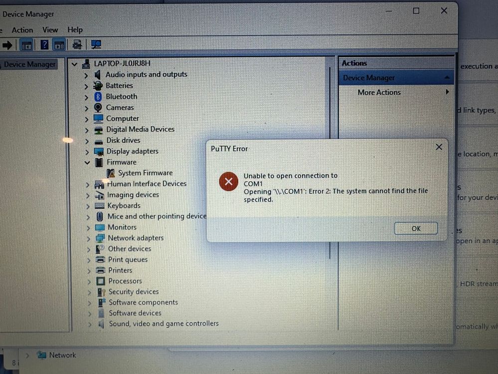

12-15-2023 01:50 PM - edited 12-15-2023 01:59 PM
I have followed all the directions listed above and am running into the issue where I can't find the ports option within the device manager to see the name of the port to scan. Please advise where this could be located.
12-18-2023 05:53 AM
Hi @jmont
You will see the COM port information in the 'Device Manager' under 'Port (COM & LPT)' as shown in the screenshot below. Please check by unplugging the cable and plugging it again.
Also, please share a picture showing the Console cable connection between the Switch and the laptop.
