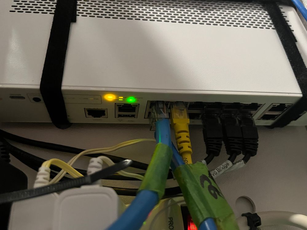

Hi I recently moved into a Lennar home with the ruckus equipment already installed and used from previous owner (They say it never worked for them). I have a ICX 7150-C12P connected to my wifi router. Only 2 lights are glowing (SYST - Orange and PWR - Green). There are 2 AP's connected to the switch and no lights on either of the APs.

Based on the information you've shared and the screenshot provided, it appears that the RUCKUS ICX-7150-C12P Switch is experiencing an issue where it is stuck in boot mode, indicated by both an Amber and a Green light.

Thank you for your response. I have tried to reset following the steps, but all the lights the PWR are blinking continues for more than a day and all except for PWR are Amber.
